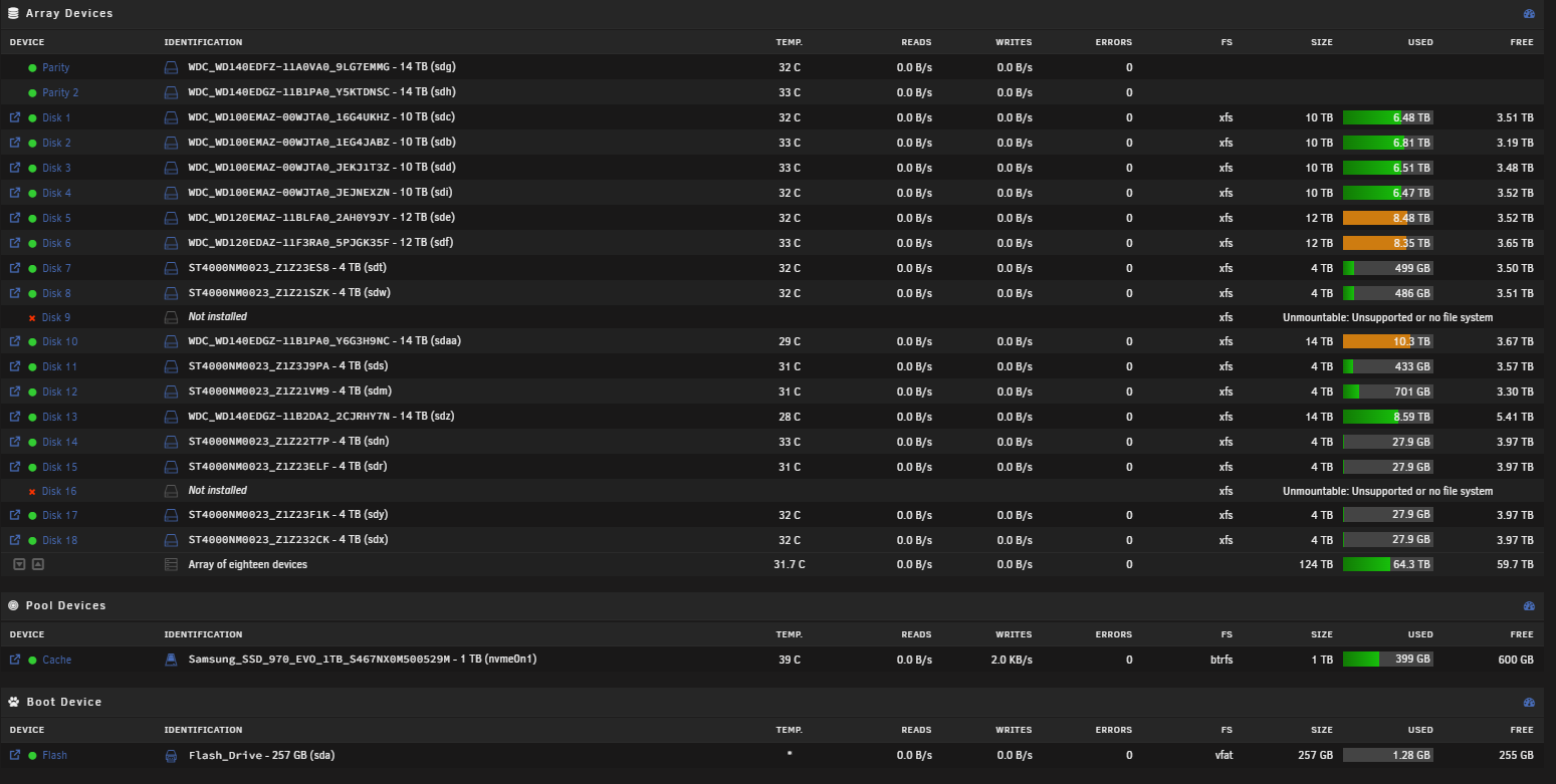

July 4, 20242 yr Author Disk 9 and 16 were pulled since they were failing. This is why I'm trying to stop the array and rebuild so my parity can be rebuilt.

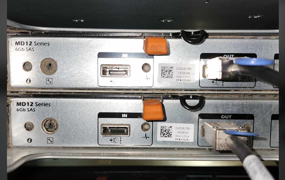

July 4, 20242 yr Community Expert Solution Jul 4 11:58:11 Server emhttpd: device /dev/sdy problem getting id Jul 4 11:58:11 Server emhttpd: device /dev/sdw problem getting id Jul 4 11:58:11 Server emhttpd: device /dev/sdt problem getting id These mean Unraid is seeing some disks twice, note that you can only have one cable from the server to the enclosure, Unraid does not support SAS multipath. After those, though not sure it's because of them, emhttp crashed: Jul 4 11:58:11 Server kernel: emhttpd[6209]: segfault at 67c ip 0000000000418336 sp 00007ffd1f8cc330 error 4 in emhttpd[404000+1a4000] likely on CPU 15 (core 7, socket 1) So you will need to reboot again, but fix the issue above.

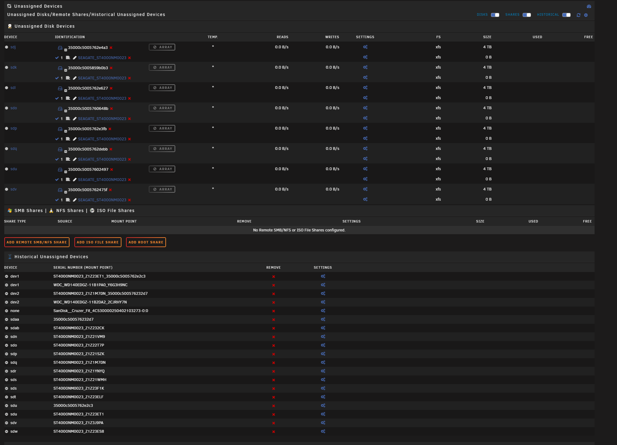

July 4, 20242 yr Author That's something I've noticed since, I want to say, I added the MD1200. It shows those drives again even though they're part of the array. I would imagine hitting the clear disk or removing partition would be detrimental?
July 4, 20242 yr Community Expert 10 minutes ago, otherworldview said: I would imagine hitting the clear disk or removing partition would be detrimental? Don't do that, just disconnect one of the cables.

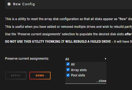

July 4, 20242 yr Author Pulled the cable and it cleared up. Thanks for the assist JorgeB & itimpi for troubleshooting / walking me through this. Final question: Am I good with the new config options for rebuilding without loss? Thanks again and happy holidays if you're in the USA! server-diagnostics-20240704-1439.zip
July 5, 20242 yr Community Expert Before doing a new config make sure the actual disks 9 and 16 are mounting, you can test with the UD plugin.
July 5, 20242 yr Author 7 hours ago, JorgeB said: Before doing a new config make sure the actual disks 9 and 16 are mounting, you can test with the UD plugin. I unfortunately got a little excited after waiting a few hours after your response for fix and ran the new config. I'm going to have to run the parity build again because disk7 is erroring up a storm (63k errors) so will pull that and put the other two back. Considering these were drives that came with the MD1200 I'm not surprised these drives are pooping out.
