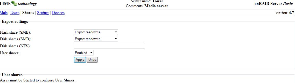

Hi, I am new to this so please excuse me if i mess up the protocol of the forum. I have little Linux knowledge but I have had my Unraid server up and running for about a year + with no issues. The other night my Blueray player couldn't see the shares. I saw a tutorial that said use *® in NFS to allow read access to all files. I tried it and still couldnt access the share. I removed it but then discovered Win7 machine could nolonger mount them either. In Unmenu I have a message ' SAMBA is STOPPED, Shared drives will not be visible on the LAN'. I tried restarting and rebooting to no avail. I have the following shares defined and the files are visible in Unraid file browser

Yes the array is started. It appears that when I put *®in the NFS box it started NFS and that appears to have caused the Samba config file to be deleted on start up I can see that happening in the syslog. I don't know how to reverse what I did. I think i need to redefine the shares under samba and stop NFS from starting. I also noticed that when I stop the array and go to the shares in main they are gone. can I just redefine them?

hi, i can do that but I doubt its applicable. I made this out of an old compaq preserio that i upgraded the power supply and fans and put 3 disks in. it is my first attempt at an unraid system and it has worked great for 1+ years. this whole mess started when i added the *® in the NFS box in the shares, it seemed to have caused something to removed the samba shares. Do you think I can reenter the shares in the configuration and start it up? would it find the data? I thought i read an article of somebody populating the drives first then putting them in the array and allowing parity build in the background. They couldn't have built the shares until the drives were installed.
