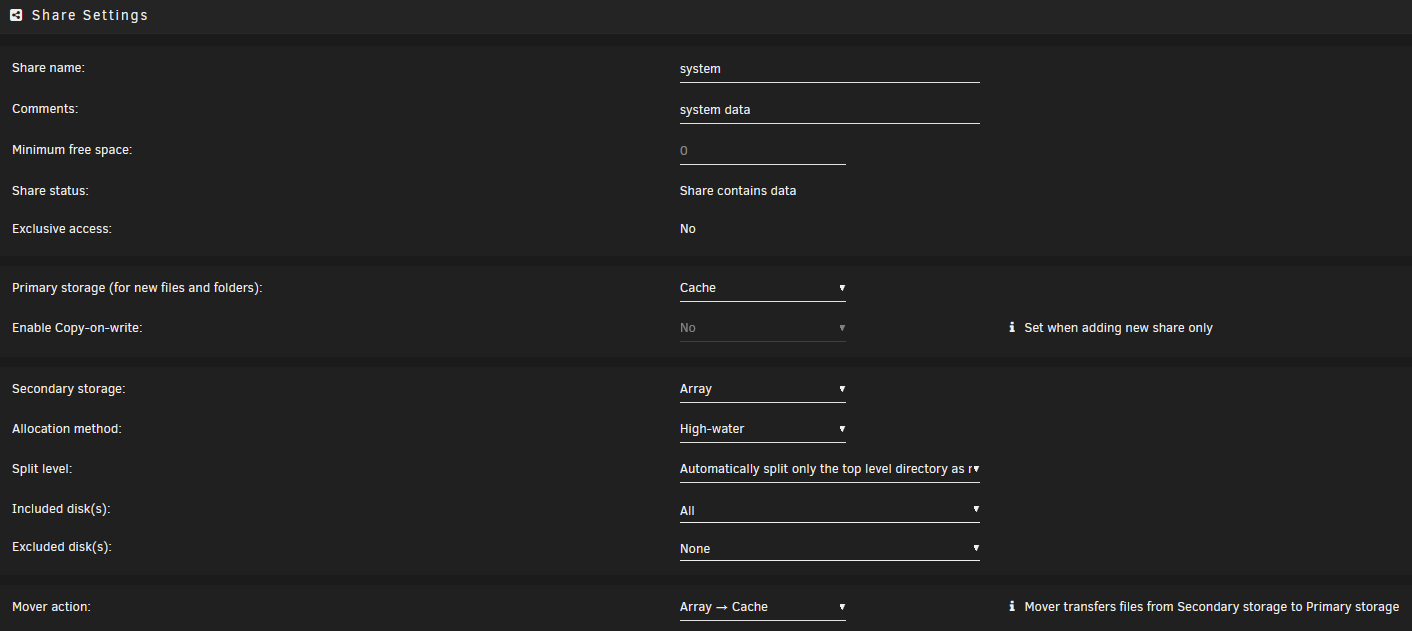

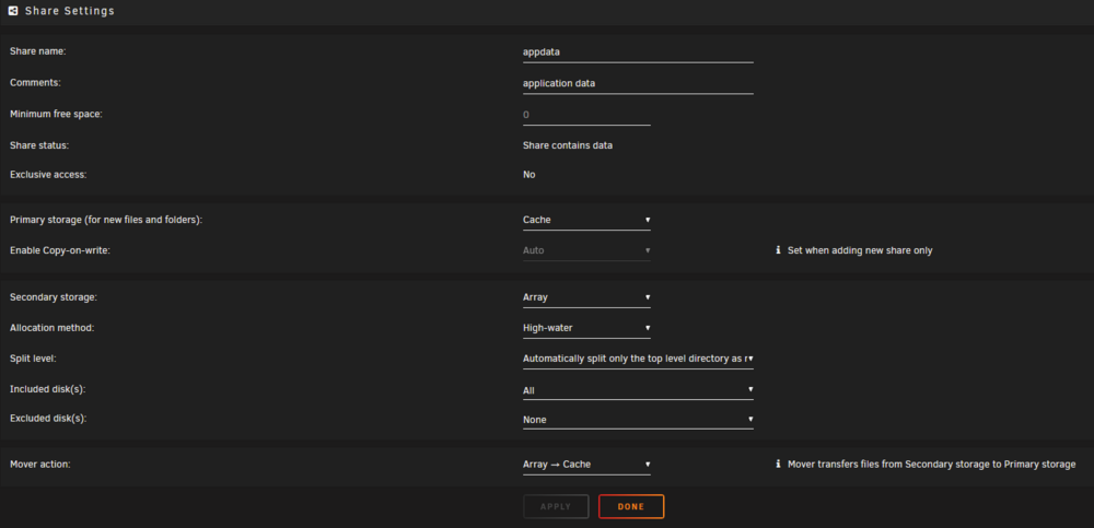

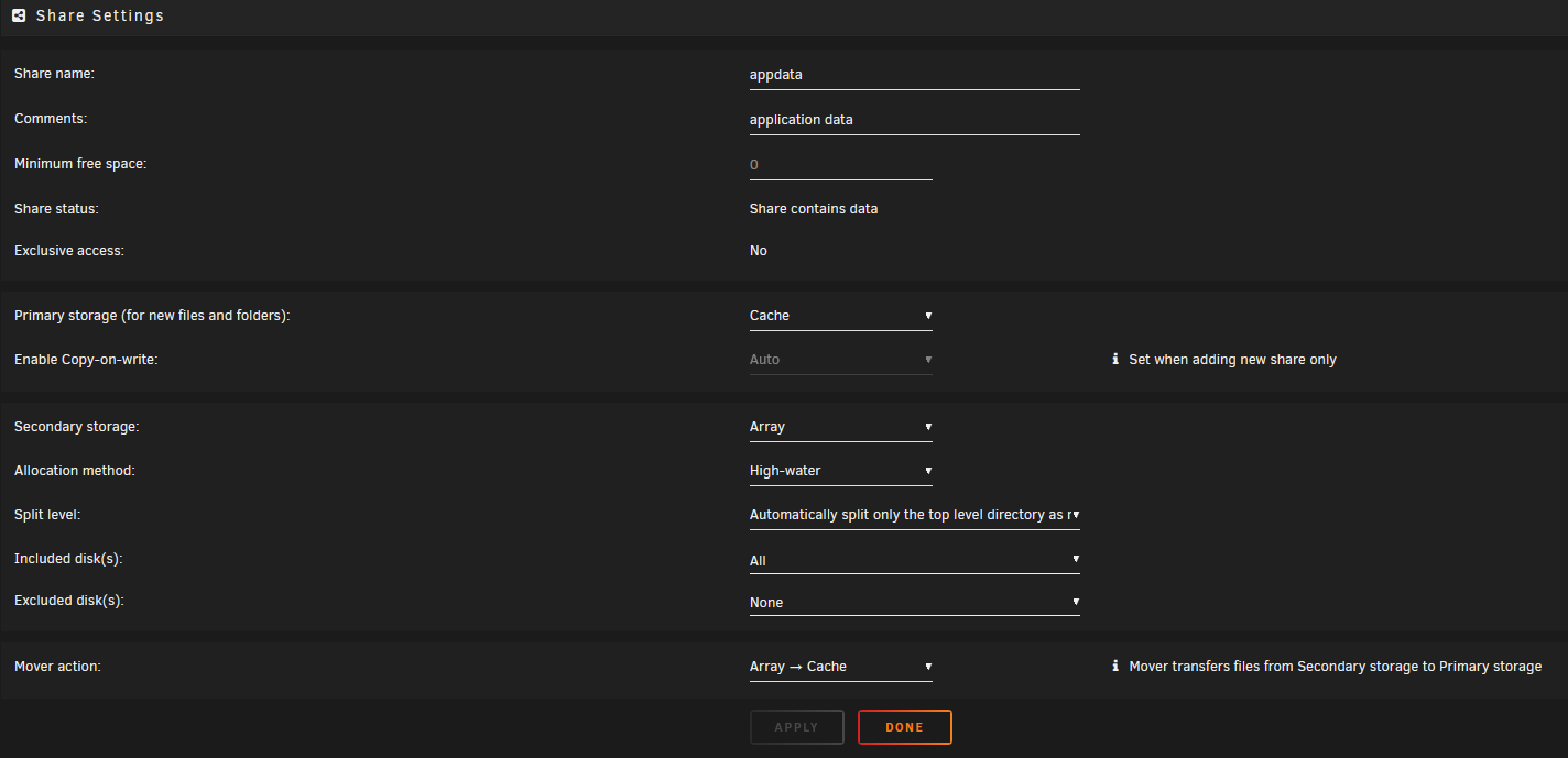

In one of the latest Unraid versions it changed slightly how shares are configured. Currently if you wanna use a cache drive combined with the array and move the data with mover to the array you have to define 2 options. In my case I have set the appdata share to be on the cache pool:
I have set the primary storage as Cache and the secondary as Array and the Mover action "Array -> Cache" so if Mover starts it always will move files to the Cache pool. With this setup I see the same info as you because the files are not protected by the redundancy of the array if the cache pool only consists of 1 drive. If you have a mirrored pool with 2 or more drives the warning will go away.
The reason why I have set it up this way is to be able to spin down the array disks. As an example if you use Nextcloud or Jellyfin/Plex you will always see some activity which will prevent the array disks to spin down. In my example if you switch the Mover action at the bottom of the share settings to "Cache -> Array" the unprotected files message will go away. In case of the drive failure for the single drive cache pool I have setup to backup the whole appdata folder each night. There are different ways to do this. "appdata backup" for example is a useful plugin for this.
Most people have set it up this way that the appdata share housing all the docker configs and databases, sits on a fast ssd pool, single or multi drive, depends on the setup. In my case I use 20+ dockers and the size of the appdata share is 18GB. So it's not a big waste of space.

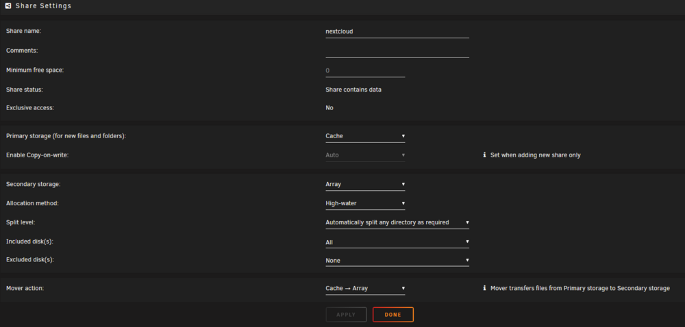

As I said, depends on your usecase, you don't have to. Nextcloud for example if only using the array will prevent disks in the array to spin down if you use it on your phone, upload pictures, sync calendar and contacts. So it's better to combine it with the cache option. In my setup all my data I upload to Nextcloud will be stored on the cache pool first and moved to the array at night. The setup for the Nextcloud share hosting all the user data looks like this:
  • primary storage: Cache
  • secondary: Array
  • Mover: Cache -> Array

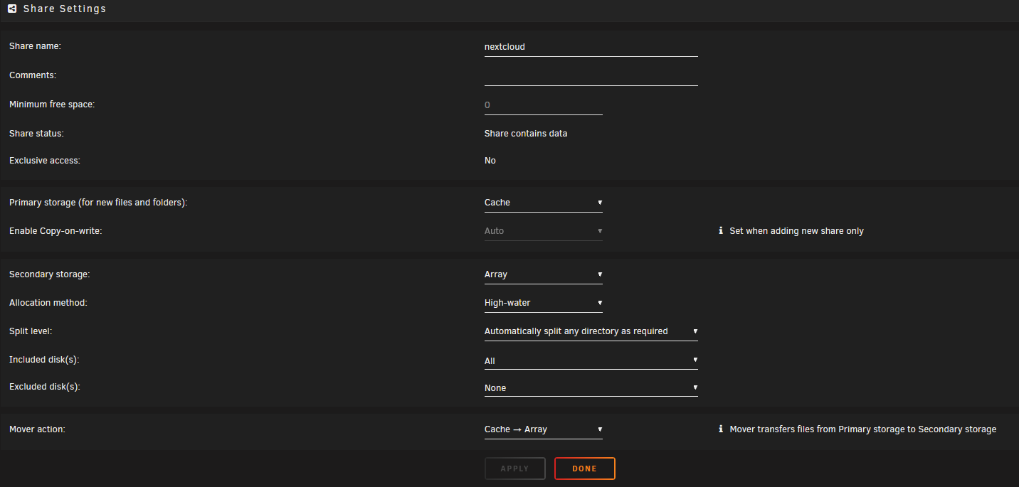

example for my Nextcloud path mappings:
As you can see all the configurations from Nextcloud are mapped to the /mnt/user/appdata/nextcloud path and the user data are in the /mnt/user/nextcloud share. Don't blindly try to replicate these bindings. They differ depending on which Nextcloud docker you're using. Just as an example.

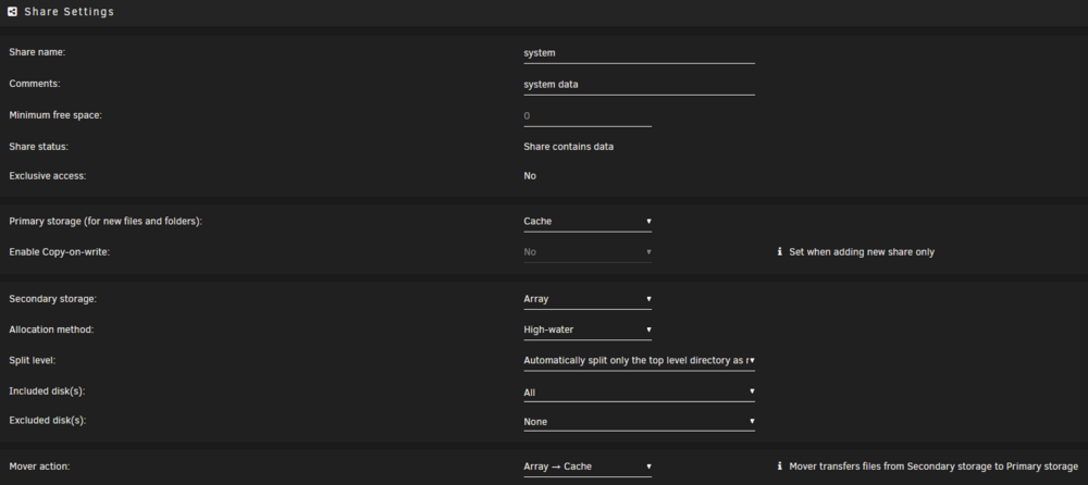

  4. check your system and appdata share settings, for appdata see my first picture, the system share should look like the followinggrafik.thumb.png.3a58098d357accde7be705f88cee96b8.png

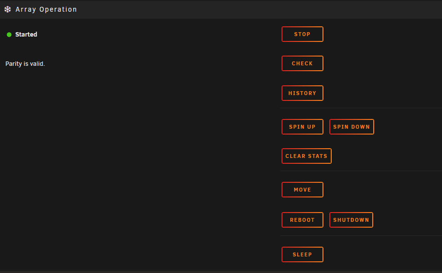

  5. go to the main page of unraid and start the mover by pressing "move" and wait till it's finished. As long as it's moving filles, the button will be grayed out.grafik.png.aff8f2eb295e696a75b9ad0c875ba8cd.png
