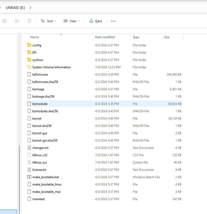

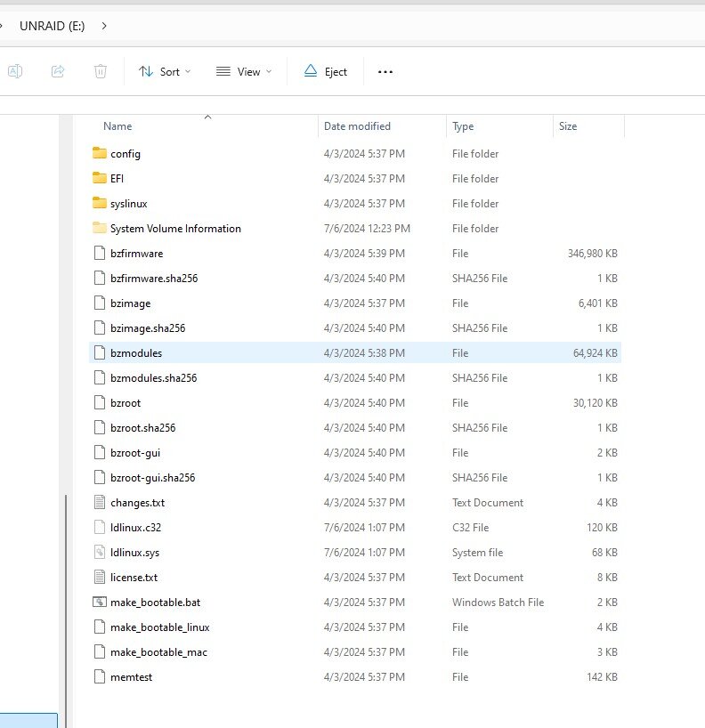

I've created the USB using Unraid USB Creator here: https://unraid.net/download, but the files listed are not there. I'm at a lost.

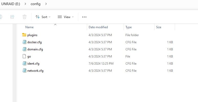

I think the instructions in the manual that you have quoted are slightly wrong (should not have "boot" in the name) as the files to delete are:
  • config/shadow
  • config/smbpasswd
The names as quoted with the "boot" in the name is what they would be when the flash drive is mounted within Unraid itself.
And if the files are not in the config directory, then no password has yet been set.
This is the USB I made. I don't have the config directory on the LincStation NAS. I would not even know how to get it off of the NAS.
Are you saying you have pulled the USB drive out of the LincStation (I believe it is plugged in inside one of the NVME bays) and checked that.
