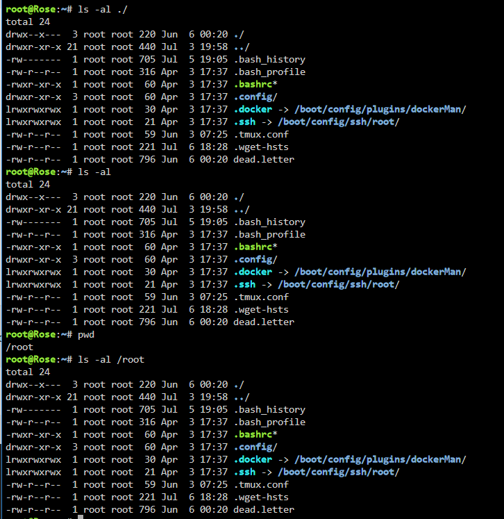

As a further bit of information, the 'proper' way to pass the pwd to a command is to use period followed by a slash--
Showing what I mean:
Notice that all three of these give the same result.  These types of insights can only come by in-depth study and experience using any OS at the command line level.  While the   ls    command assumes the pwd as the default path, any Command the requires a path will require that the path be fully specific.  I thought I might post up what the    ls -al  /*    would output.  Then I tried it and discovered that the output was everything in the entire file system!  (Give it a try and see what I mean!)
