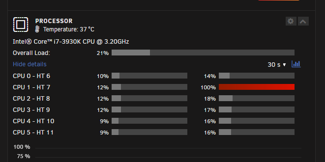

I can also see one core going ham (attached).
EDIT: that thread has seemed to have calmed down now not sure what caused that

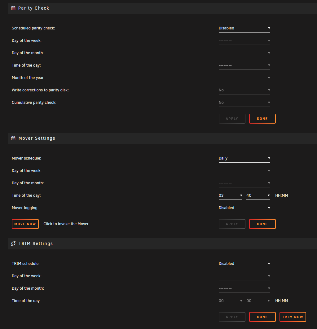

Nothing under scheduler, UPS or any other menu I can see
Is there anywhere else I should be looking?
