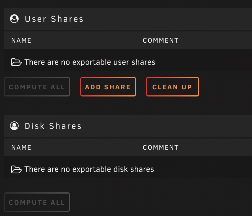

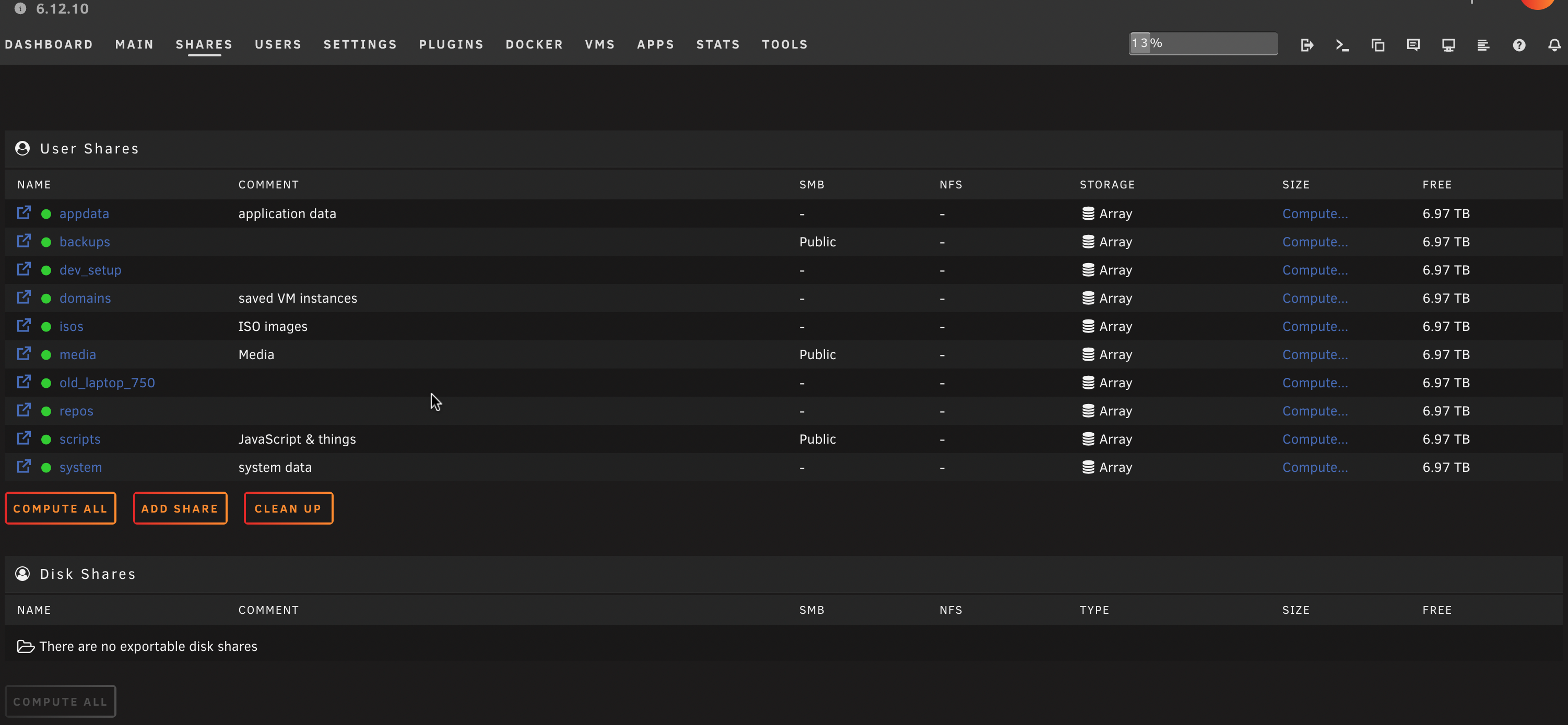

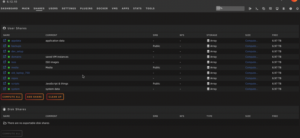

July 12, 20242 yr Before: After: I recently tried to add a 128GB SSD drive as a cache drive. I ended up not wanting to keep that and ever since I removed the drive, this issue has been happening. If I reboot the server, the shares show up again for a few minutes but then disappear. What's going on? Edited July 12, 20242 yr by qodesmith typo
July 12, 20242 yr Community Expert Jul 12 10:56:07 cordova-server shfs: error: strcpy_share_path, 456: No such file or directory (2): path too long: /└───┴───────────────────┴───────────────────────────────────────────────────────────────────────────────────────┘ A reboot should bring them back, but it will likely happen again if you try to read whatever that folder is.
July 12, 20242 yr Author @JorgeB Yup, rebooting does in fact bring them back, but like you said, it goes out again. Is there a way to find out what path that is? And where in the diagnostics did you find that?
