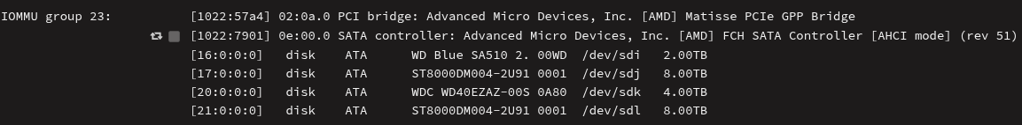

Besides that, three hard drives from my array dropped away and were listed under Unassigned devices. In panic, I shut down the VM and then the server completely and after booting back up, luckily everything was back to normal again. Note that I no longer have that VFIO bind error that I was getting before, but apparently still something is not right with my configuration. I now have it configured as follows:
Note that these two devices are the only devices being passed through to the VM and are also the only two devices in the device list with the 10:00 device identifier (or however that should be called).

Jul 13 14:44:04 Olifant kernel: ahci 0000:0e:00.0: AHCI vers 0001.0301, 32 command slots, 6 Gbps, SATA mode
Jul 13 14:44:04 Olifant kernel: ahci 0000:0e:00.0: 4/4 ports implemented (port mask 0x33)
Jul 13 14:44:04 Olifant kernel: ahci 0000:0e:00.0: flags: 64bit ncq sntf ilck pm led clo only pmp fbs pio slum part
Looks like an issue with this controller; it got detected again, like if it had dropped, though I can't see when.
Thx Jorge,
that would make sense because the drives that dropped away are exactly the drives connected to that controller:
I need to double check, but I am pretty sure this is an onboard controller on the motherboard. The issue basically occured the minute I started up that VM, I will check later if I can reproduce the issue.
That makes me think the VM may be trying to passthrough that device, which VM since there are multiple ones?
It is Jabberwocky.
Indeed you are right, that could be, but I cannot understand why. I only want to pass through the graphics card and sound card (10:00.0 and 10:00.1), which I have selected in the VM config.
Yep, looks good to me. Do you have ACS override enabled? That can sometimes cause strange issues.
No, it is disabled.
