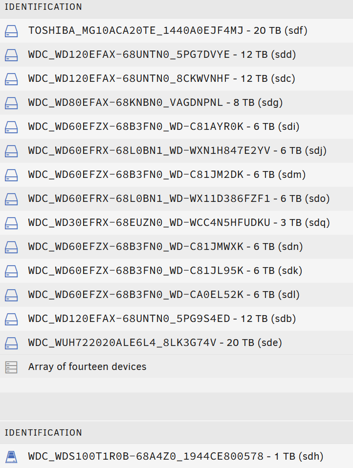

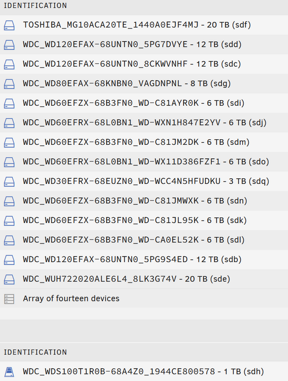

HDD x12 (see attached photo)

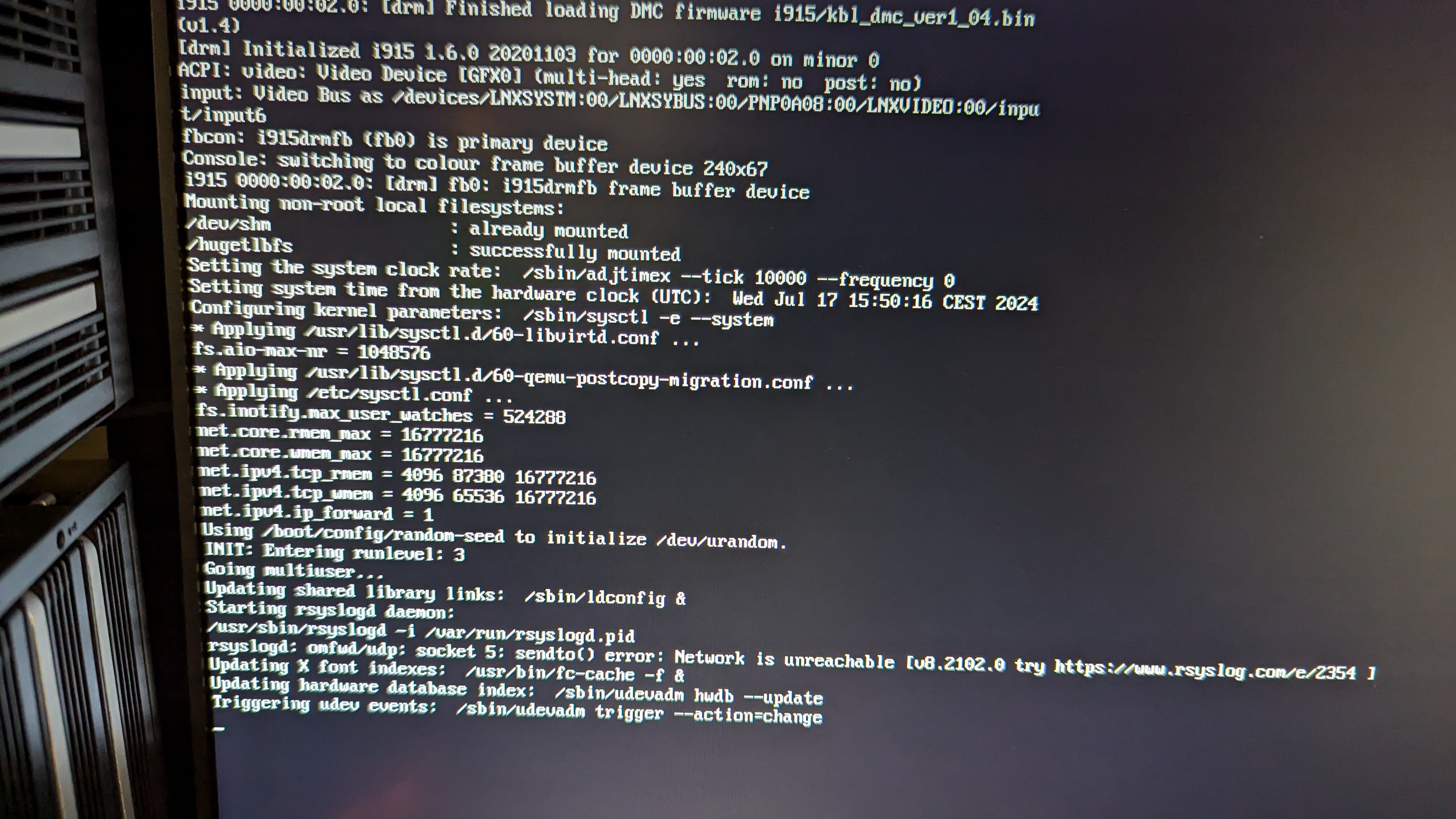

At the moment, I can't start the server with this card, it crashes at this screen on startup:
And so I can't provide syslog with the sata card in place.
Edited by botteur
If VT-D is enabled try disabling it, it helps with a similar controller.

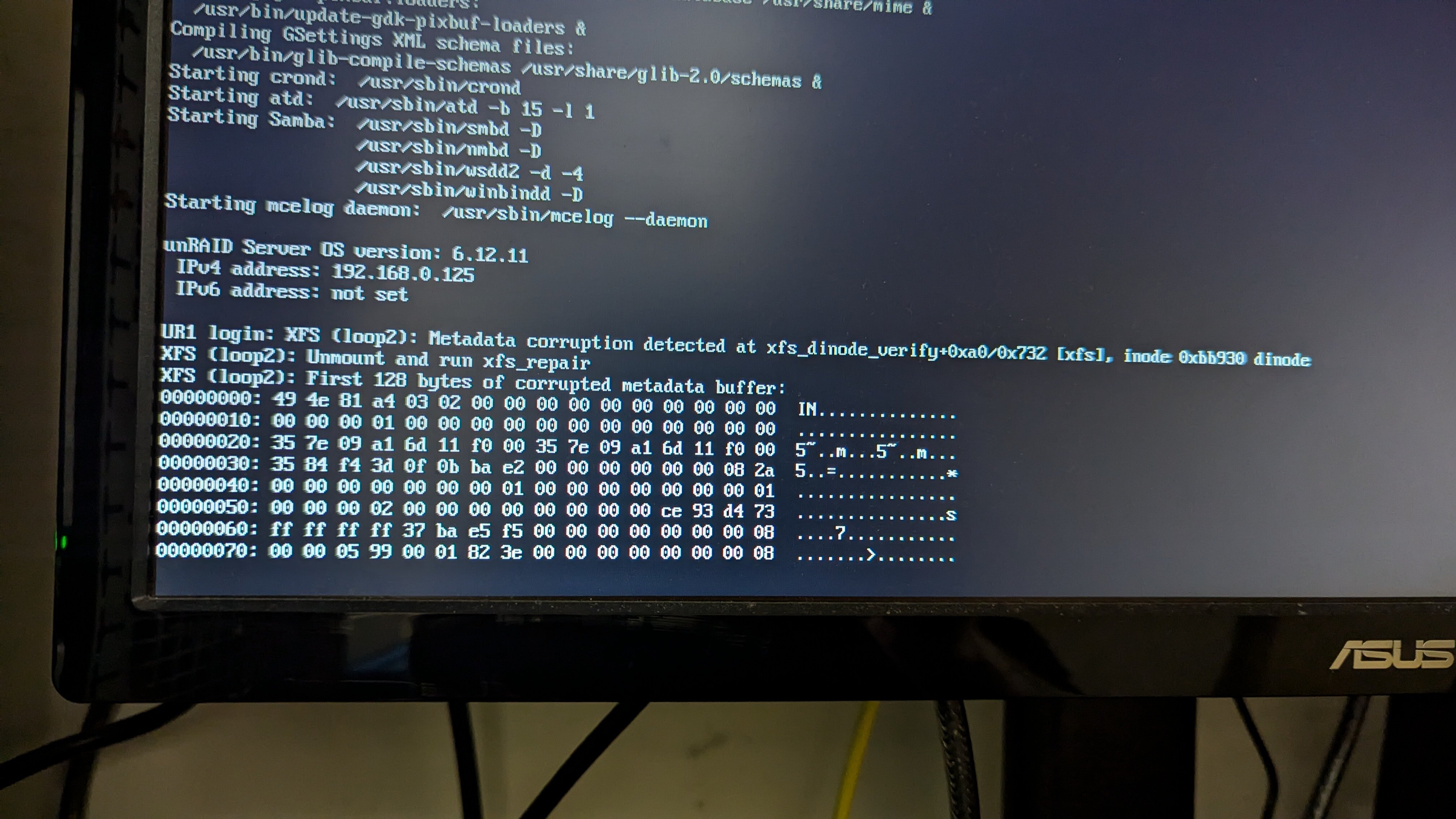

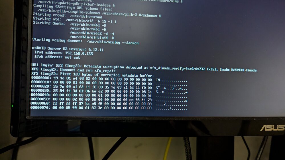

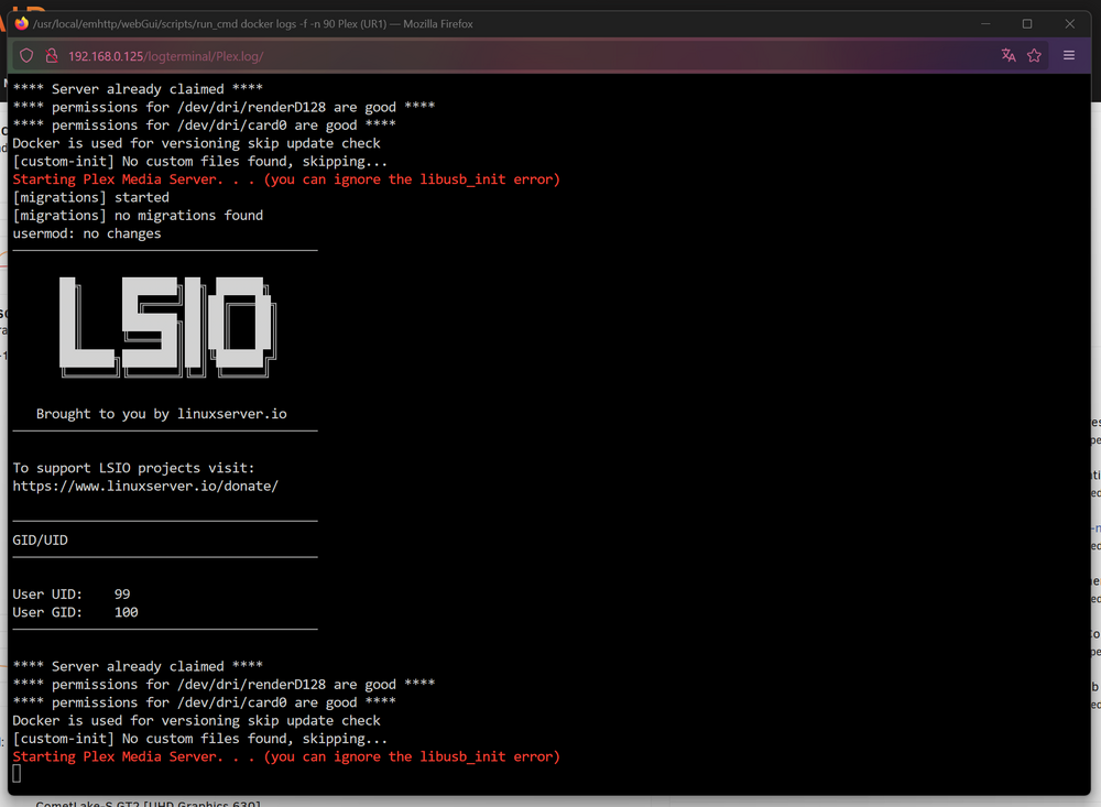

For most of my dockers, everything went well, but for the bigger ones (Plex, Jellyfin, Nextcloud, Transmission ...) it's more complicated!
Typically for Plex, I get this kind of error.
the docker launches normally but I get an error displaying the web ui.

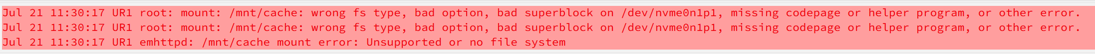

So I had my syslog blank and here I just saw that I have this as an error:
I thought it was because of the file system because I had formatted the new ssd in xfs.
Since that didn't work, I reformatted it as the original ssd was, i.e. btrfs.
But even so, it still doesn't work.
Is there something wrong with me?
These happened before the pool was formatted, so it's normal.
Well, I don't know what to do.
That looks like a corrupt docker image, but would need the diags to confirm.
I don't see that error in the diags, did you reboot?
