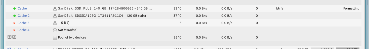

Hey folks,
I am trying to make a zsf pool that's just a stripe pool to handle downloads I am doing.
I started formatting them to do this 2 days ago - but its sitting and formatting.
Is there something going on thats stopping this? what am I missing?
Thanks

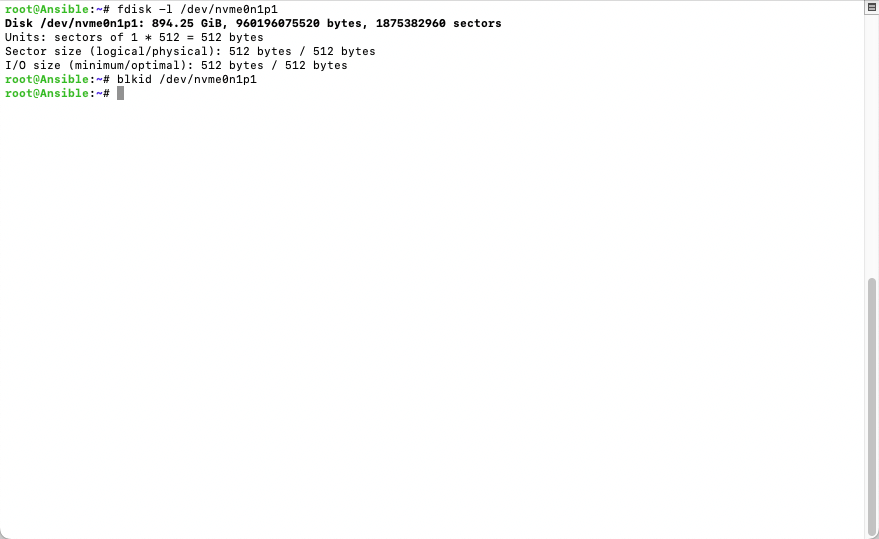

emhttp crashed again, reboot and before attempting another format, post the output of:
fdisk -l /dev/nvme0n1p1
and
blkid /dev/nvme0n1p1
I couldnt get anything from the second command
