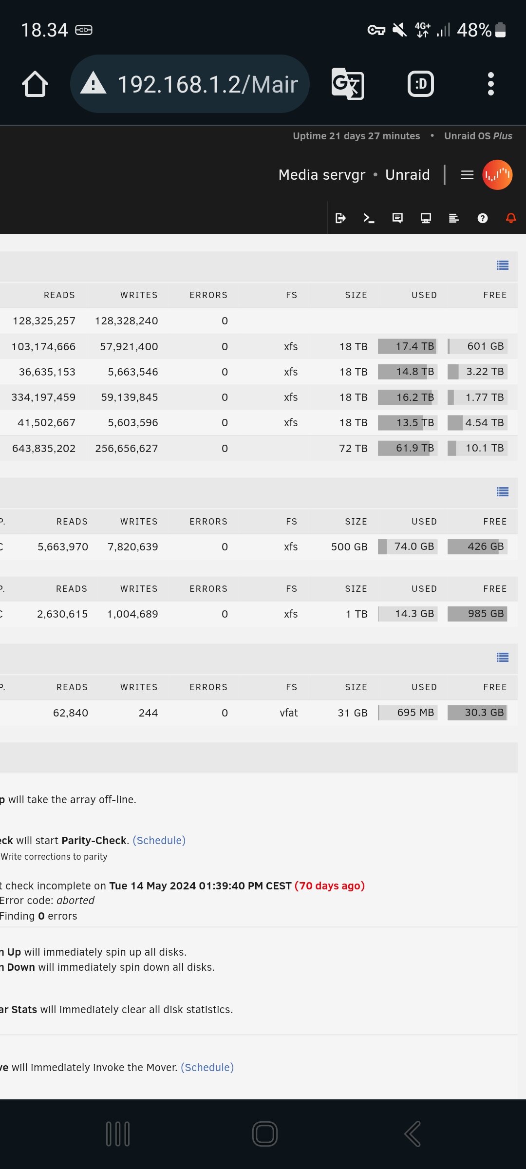

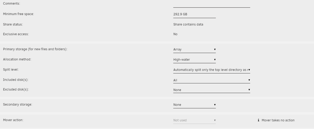

July 23, 20242 yr Hi I have high water enabled for all my drives but it doesn't seen to work correctly. See the picture how different the drives have filled up eventhough they are same size.
July 23, 20242 yr Community Expert Note that split level overrides allocation mode, you should also post the diagnostics and the share(s) name you are using.

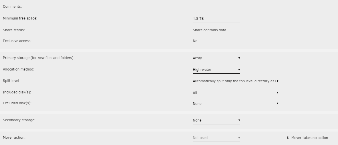

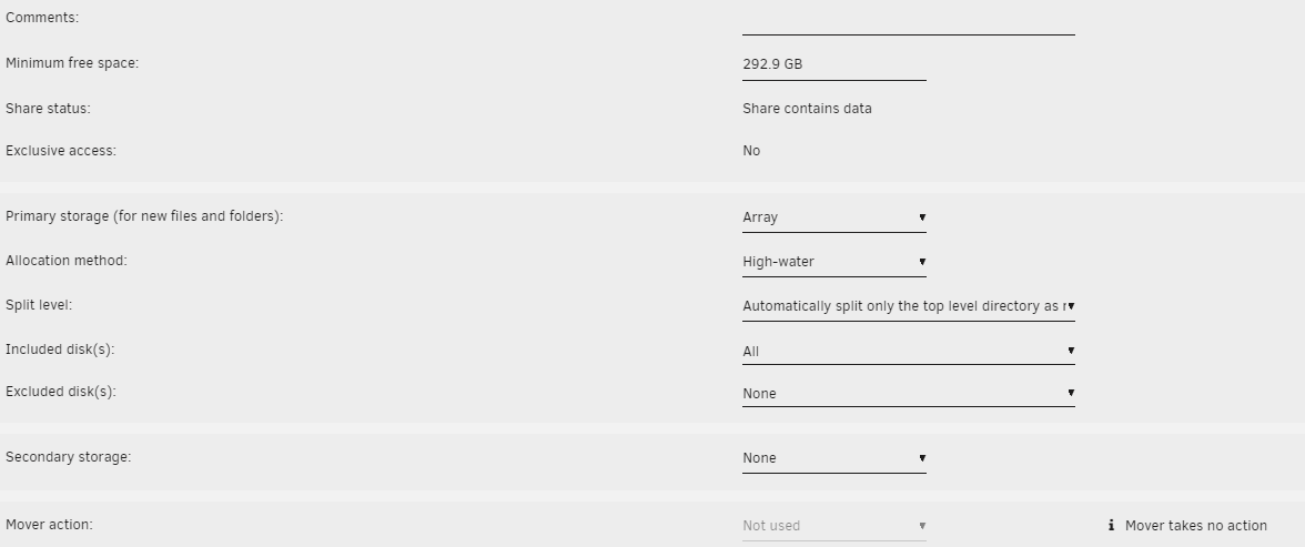

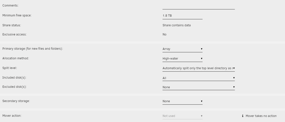

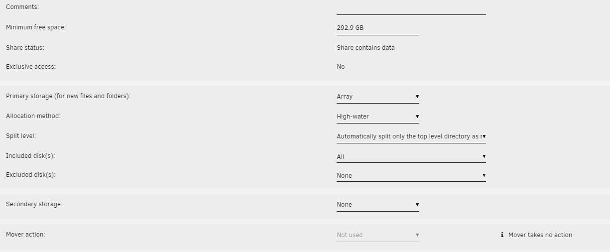

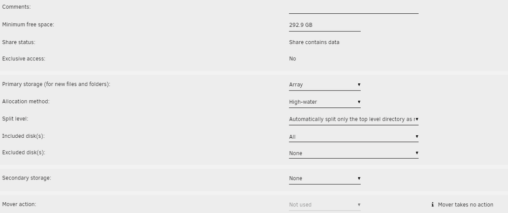

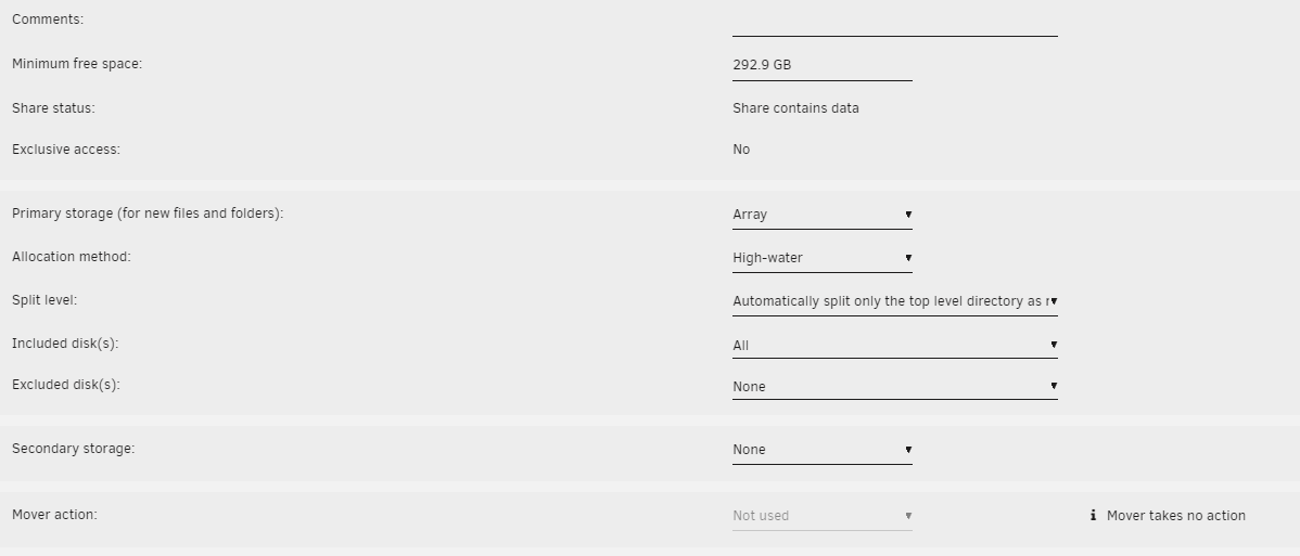

July 23, 20242 yr Author Thanks. Please see diagnostics and attached screenshots. Share 1: Share 2: Share 3: Share 4: Share 5: unraid-diagnostics-20240723-1938.zip
July 23, 20242 yr Community Expert First update to latest stable, there were some allocation related bugs in other releases, but all those shares have a split level set, and has mentioned, 40 minutes ago, JorgeB said: Note that split level overrides allocation mode
July 23, 20242 yr Author 55 minutes ago, JorgeB said: First update to latest stable, there were some allocation related bugs in other releases, but all those shares have a split level set, and has mentioned, Have updated now to the latest, but how should I set it then to have it split correctly with high water?
July 24, 20242 yr Community Expert Set a share to split "all" and retest that way, if new data goes to the correct disk, split level was the problem.
