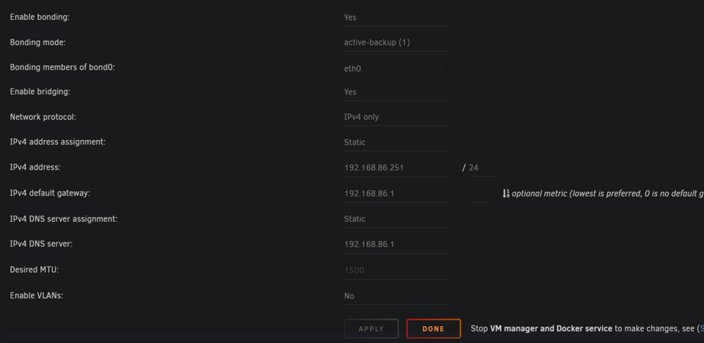

How are you assigning the IP address for your Unraid server--- DHCP or an assigned static IP address?
If you have assigned a Static IP address on your Unraid server, have you reserved that address on your new router?

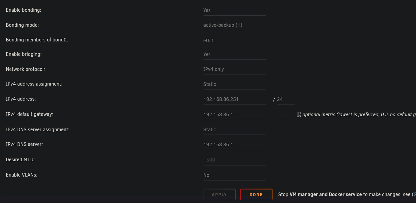

The IP address is static on both ends - from UNRAID and the Asus Router. I am not sure if I can share the local IP here.
UNRAID:
Asus Router

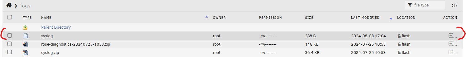

Setup the syslog server using the 'Mirror to Flash' setting.  Then the next time it occurs, shut the server by pressing the power switch for approximately one second.  That should shut the server down cleanly.  Then pull the flash and get the file from the   /logs  folder and up load it in a new post.

I did but its just that there is so much logs. The folder names there do not to match the date I enabled it.
logs.zip
I download your logs.zip file and it was not in there.  Your Syslog Setup should look like this:
And the  /logs   directory/folder should then contain this file:
That is the file that we are interest in seeing if you can't get the diagnostics file after the problem occurs.  If the GUI returns on its own after the problem, get the diagnostics file and upload it as well.  (The diagnostics file is useless if you have to reboot the server to get the GUI back!)

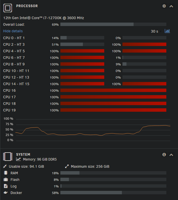

I think I have found out the problem before it happens and was able to prevent it. Lidarr has been grabbing a lot of files lately so Plex has been consuming a lot of RAM running Sonic Analysis. The RAM has been sitting at 99% and the UI started not responding. I was somehow able to stop Plex and the UI was then more accessible and I was able to navigate through it smoothly.
The RAM being filled would explain why the UNRAID is the only one inaccessible despite the router change. I guess a coincidence?
It also explains why it is pingable. If it was a problem at the router level, it shouldnt be pingable.

I managed to grab a screenshot before it kicked me out and hopefully the syslog is correct now. I had to manually turn it off to grab it.
syslog
