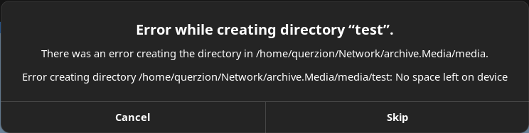

My 18 TB is filled. . . ??

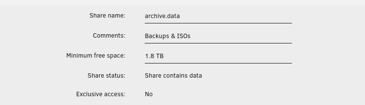

Seems I have been very conservative setting it up, 1,8 TB 10%? What should I set it too instead?
What's the absolute bare minimum I can set it to?

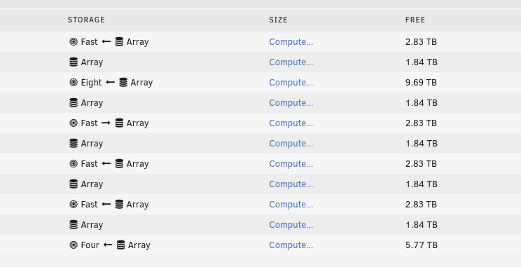

Also, How do I force the mover to actually start moving the files I told it to move about 5 days ago?
I had to manually move the dockers, and I thought things like that was going on in the background,
but nothing happened so I ended up just moving them manually. When I tell it to move,
I kind of expect it to force move the files directly. "/
Depends on your risk tolerance. If there is ever any file system corruption, you need a significant amount of free space for the check and repair to succeed. That is one reason for the conservative free space of 10%.
Nothing can move open files, so if you have the docker service enabled, the files won't be moved. Also, you many have accidentally made copies, and they won't get overwritten. To see what's going on, temporarily enable mover logging, run the mover, then look at the syslog. Be sure to turn off mover logging, it will clog up the logs with all the extraneous junk.

I'm moving 500+ GB's to the 8TB right now, I don't know if I'm doing it right though, pushed on the disk1 and move and then eight, which is the name on the extra pool I created, since the 8TB is 5400rpm, and the 4TB is 7200rpm, I separated them into two different pools, and I don't really need that much space atm, have a lot of things I have to watch etc. and the VM's I'm going to move after I have moved the backups to the 8 TB, the dockers are now situated on the fast pool, which is a m.2, but I'm seeing a lot of reads and wonder how long it's going to hold up before I have to to get a new one, and I'm thinking of having 2 x 2 TB, and have one as redundancy, and then put in another 2TB ssd to act as a cache, perhaps even 2x2 TB SSD's just for that purpose, but I don't know how the cache works, does it make a sequential move often or  less often? If it breaks and I lose hours or even weeks of work it's not really going to be a good fit to only have one. The main pool is only one 18TB atm, but I'm planning to buy another asap and put it in as a parity, and the month after, buy another 18 TB to add to the pool. when I have a pool of 2x18 TB plus a parity, I'm going to start focusing on cache, and move out the 8 & 4 TB drives from the case entirely.
