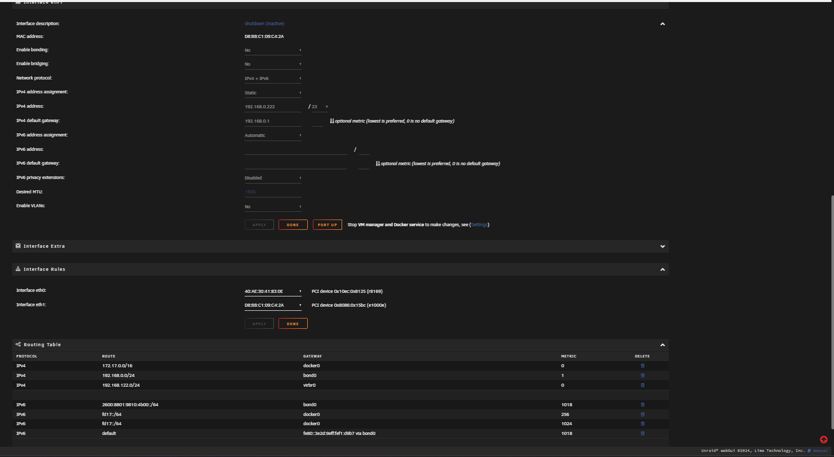

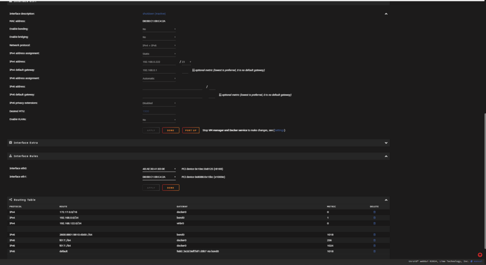

eth0: https://imgur.com/na8Whlp
eth01: https://imgur.com/y4PGlzZ

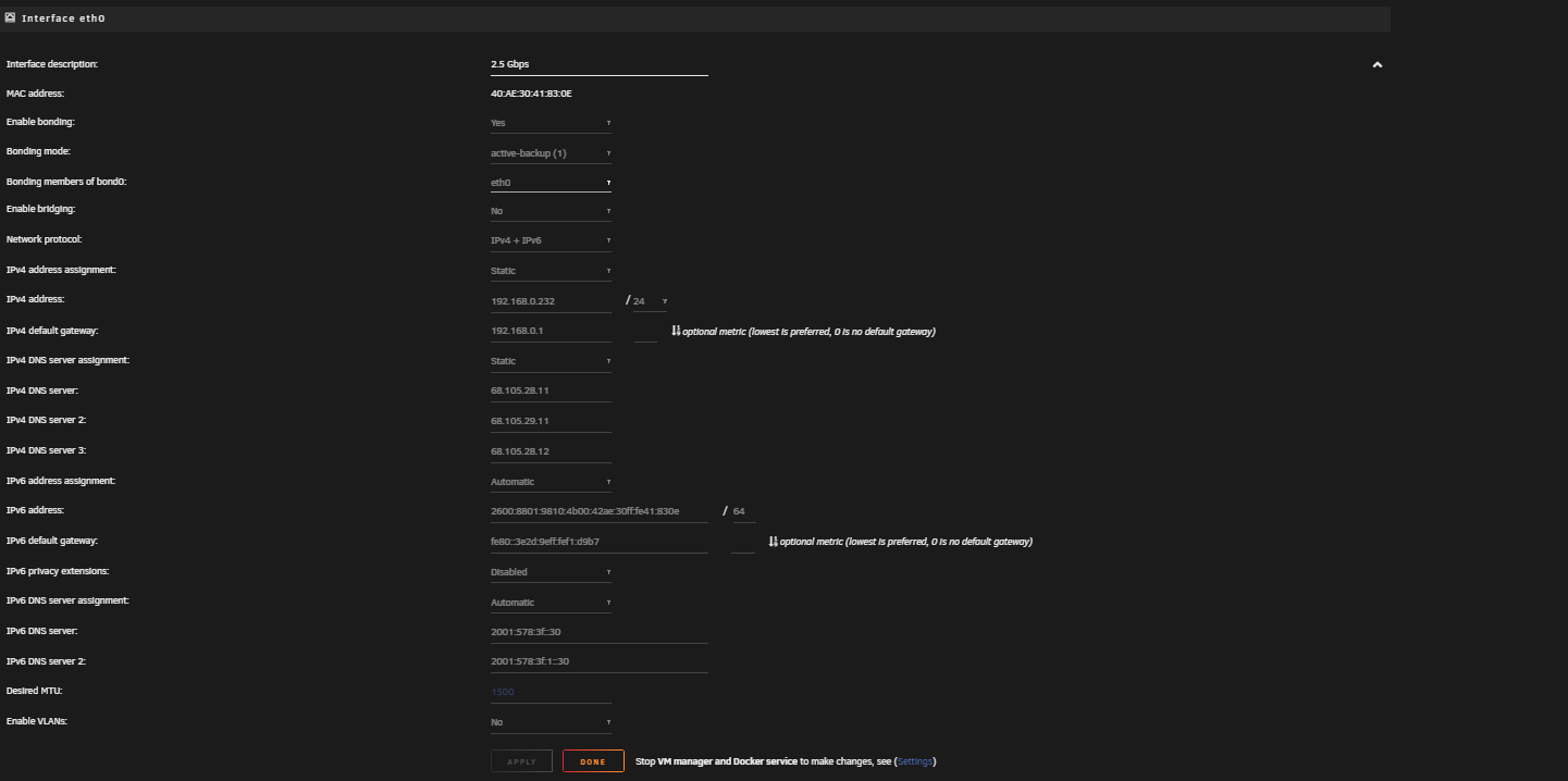

sure, cannot work at all!
On eth0 you have activated bonding in "active backup" mode, but the only bond member is eth0.
Giving eth1 the same address and config does not work (as you might know now already :-.) )
Instead, add eth1 to the bond of eth0 (the eth1 config will vanish, it is not needed).
But keep in mind, nothing will become faster or better or more reliable. Active backup means that only the first line is used unless it loses connection. Then Unraid switches over to eth1. It helps if the cable is killed by your hamster, but nothing else.
Thank you I just did this what should I change the Active back up to ? any recommendations.
https://imgur.com/Dfx0tV0
Nothing to do. Active Backup is the only Bond that makes (at least) a bit of sense.
All other modes require support from your switch and also do not give speed benefits unless you have hundreds of clients to feed.
Bonding (aka "port aggragation") is usually overestimated, it does not help in normal environments.
Normally you dont need it, just pull out the cable on eth1, turn off bonding and disable the card. You sleep better with this, believe me. And keep the hamster within its cage.

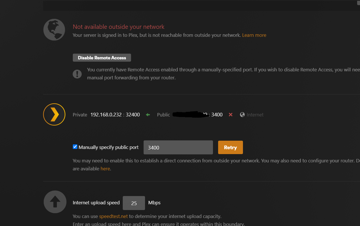

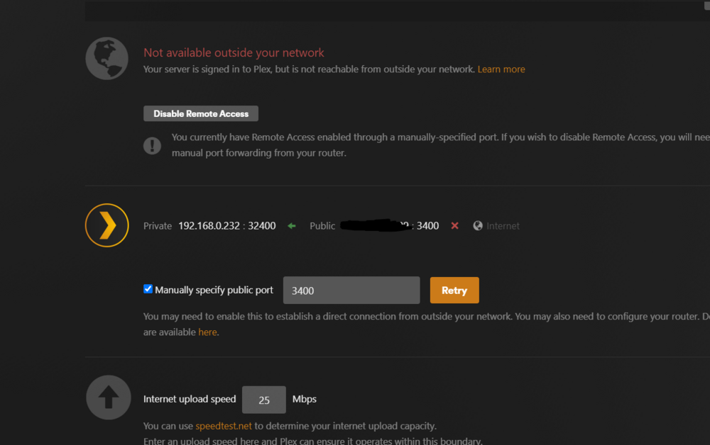

okay I do appreciate it! 1 last thing is now plex isn't resolved. Literally everything was working fine until I added this card lol
It keeps flip flopping from working to not working
you may need to wait up to 60mins to clear som caches
okay
I will let it set over night and check in the morning. Thanks
it may happen because of your active backup bond (former). "the others" (mainly your router) learns which ip address uses which MAC (hardware adress, unique for each card) and stores the info in the so called ARP cache.
If the bond switches the cards, the others do not know and there is a grace period up to one hour in which they try to answer to the old card (which fails miserably of course).
After the cache times out they relearn the IP/MAC pair and everything is fine again until the next switchover...
Thats why bonding sounds good but can give a lot of grief to the unpatient heart...

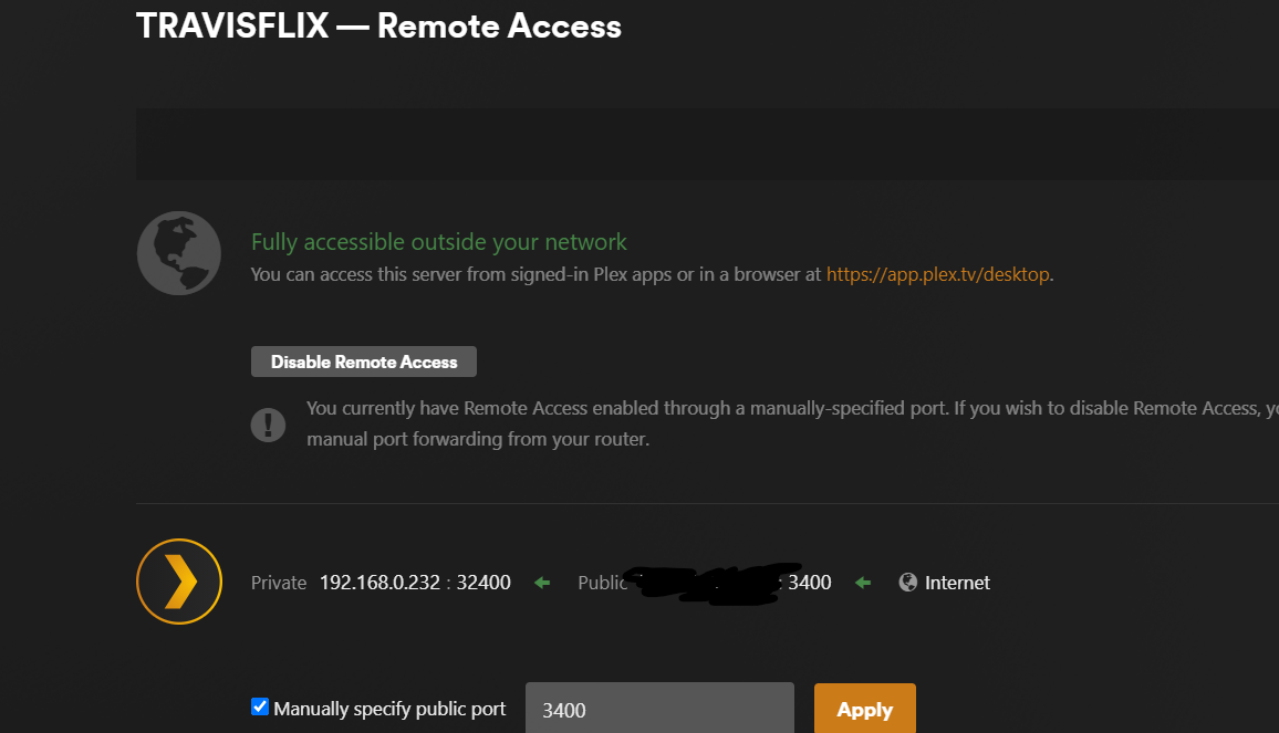

Seems plex is good to go now! But now my share isn't populating in the network folder as before. I am sure its a simple fix I appreciate the help and support you are all giving.
