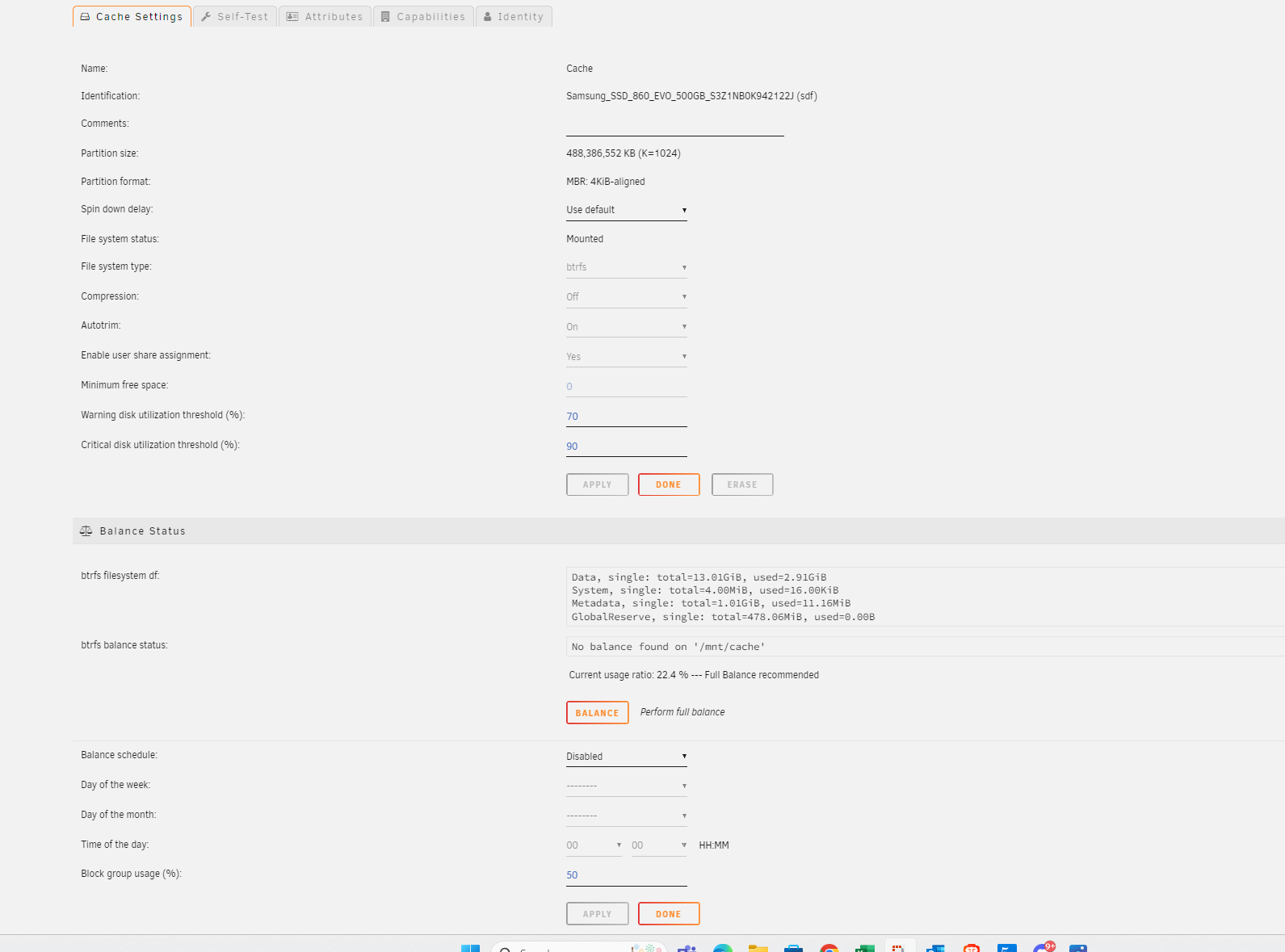

August 12, 20242 yr I have multiple issues I am fixing but right now I can't get some dockers to run and am getting the following error: PMS: failure detected. Read/write access is required for path: /config/Library/Application Support/Plex Media Server kill: usage: kill [-s sigspec | -n signum | -sigspec] pid | jobspec ... or kill -l [sigspec] PMS: failure detected. Read/write access is required for path: /config/Library/Application Support/Plex Media Server kill: usage: kill [-s sigspec | -n signum | -sigspec] pid | jobspec ... or kill -l [sigspec] Fix common problems says: Unable to write to disk2Drive mounted read-only or completely full. Begin Investigation Here The cache is now almost empty but I cant even edit min free space (see pic) Anyone know how to fix this? tower-syslog-20240812-2223.zip
