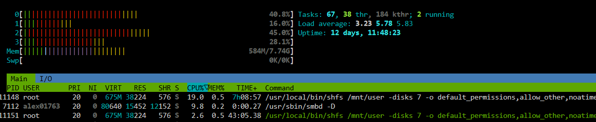

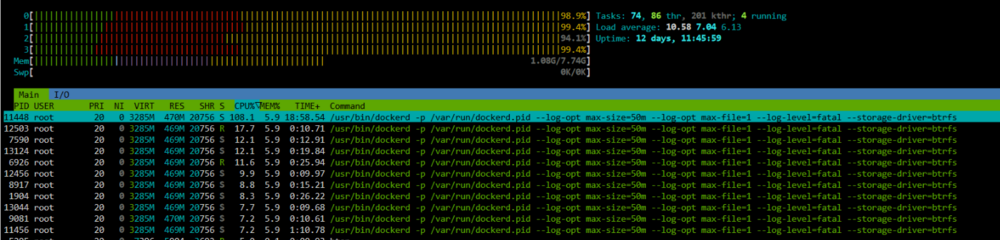

I noticed a sudden performance drop when loading/searching files when I was accessing my server from a windows machine, so I took a look at what's going on in the server. I found out that suddenly the docker service was taking up more than 100% cpu when I ran htop in the console. I stopped all docker containers, but the cpu usage was not going down, so I tried disabling docker in the settings, which calmed everything a bit. Now I'm rebooting the server for good measure. I think this is a bug in Unraid's end, since I tried turning my containers one by one, and nothing happened, which probably means the container themselves are not the fault if I'm not wrong. Am I the only one experiencing this? What should I do?
htop before:
htop after:
