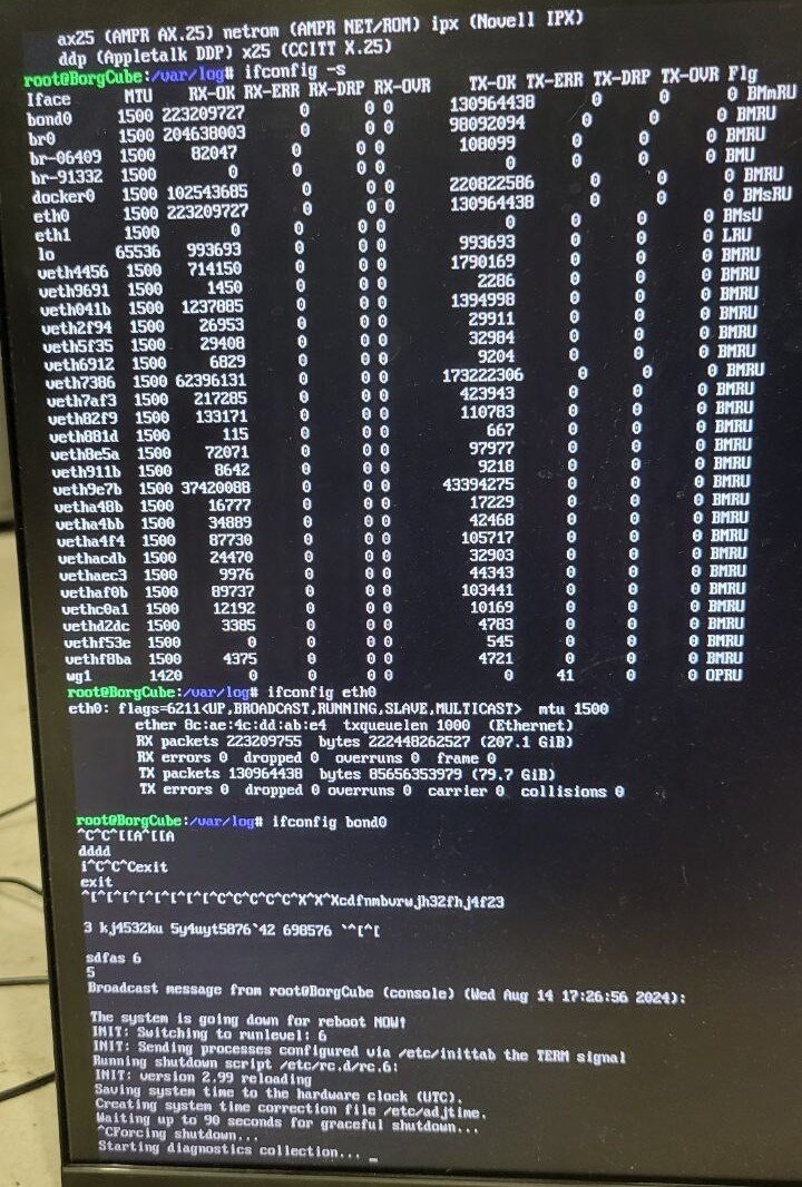

I've been battling with an odd issue for the past few days, every so often Unraid would become totally unresponsive, usually the exact moment I'm doing something on the GUI, either loading the docker page of Unraid, or accessing a docker container webui (none in particular).
Sometimes I would still be able to ping the Unraid box on the network, but not able to SSH into it (SSH would just hang).
This time around the Unraid box became unresponsive but I'm also not able to ping it. I plugged a monitor and keyboard on the box itself and I'm still able to login directly. I've tried to troubleshoot from the console while I'm able to access it, but I'm not too sure what I should be looking for. Thinking of it being a network issue possibly I started checking some of the network interfaces, however when I typed `ifconfig bond0` it became unresponsive as well. Then only way out was to do a CTRL ALT DEL, which triggered a shutdown, however the shutdown process has been stuck at "Starting diagnostic collection" for the past couple of hours. (see image)
Server's uptime before the issues started was 7 months without problems, no hardware changes were made recently.
Any idea on what I should do next to troubleshoot this issue?

Aug 14 17:06:02 BorgCube kernel: r8152 2-4:1.0 eth0: Tx timeout
Aug 14 17:06:07 BorgCube kernel: r8152 2-4:1.0 eth0: Tx timeout
Aug 14 17:06:12 BorgCube kernel: r8152 2-4:1.0 eth0: Tx timeout
Aug 14 17:06:17 BorgCube kernel: r8152 2-4:1.0 eth0: Tx timeout
Aug 14 17:06:24 BorgCube kernel: r8152 2-4:1.0 eth0: Tx timeout
Aug 14 17:06:29 BorgCube kernel: r8152 2-4:1.0 eth0: Tx timeout
Aug 14 17:06:34 BorgCube kernel: r8152 2-4:1.0 eth0: Tx timeout
Aug 14 17:06:40 BorgCube kernel: r8152 2-4:1.0 eth0: Tx timeout
Aug 14 17:06:46 BorgCube kernel: r8152 2-4:1.0 eth0: Tx timeout
Aug 14 17:06:51 BorgCube kernel: r8152 2-4:1.0 eth0: Tx timeout
Aug 14 17:06:56 BorgCube kernel: r8152 2-4:1.0 eth0: Tx timeout
Aug 14 17:07:02 BorgCube kernel: r8152 2-4:1.0 eth0: Tx timeout
borgcube-diagnostics-20240814-1801.zip
Edited by Jupiler
Try to get diagnostics posted.
Sounds good, just added it to the original post, as well as the persistent syslog when one of the crash happened
Edited by Jupiler
It looks like bonding is enabled with eth0 unplugged while eth1 is connected at 1000.
My initial thought is to disable bonding and plug your cable into the eth0 port.
