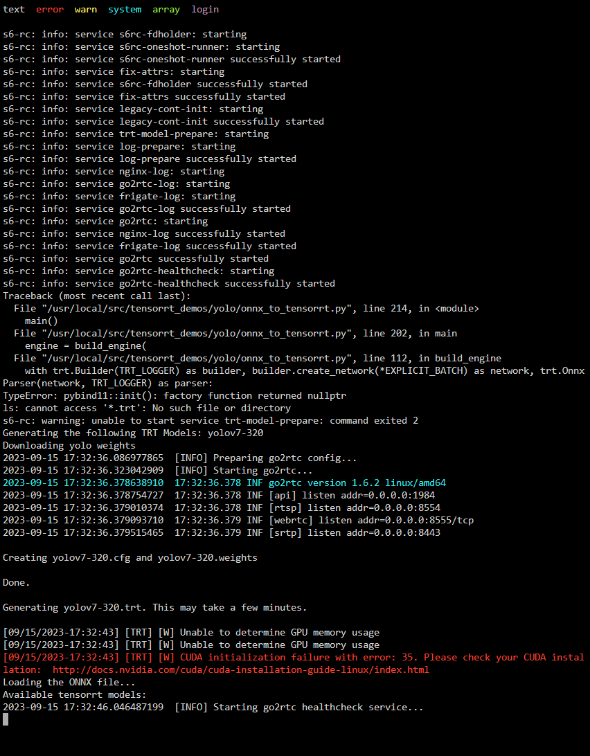

  4. I've tried your suggestion @yayitazale but the new tensorRT model generation isn't very clear to me... I'm running into the following error when running the frigate:0.13.0-beta1-tensorrt docker I don't see any reference to having to build the new models myself in the new doc: https://deploy-preview-6262--frigate-docs.netlify.app/configuration/object_detectors/#generate-models D̶o̶ ̶w̶e̶ ̶s̶t̶i̶l̶l̶ ̶n̶e̶e̶d̶ ̶t̶o̶ ̶u̶s̶e̶ ̶t̶h̶e̶ ̶"̶t̶e̶n̶s̶o̶r̶r̶t̶-̶m̶o̶d̶e̶l̶s̶"̶ ̶d̶o̶c̶k̶e̶r̶ ̶w̶i̶t̶h̶ ̶t̶h̶e̶ ̶p̶r̶o̶c̶e̶s̶s̶ ̶o̶u̶t̶l̶i̶n̶e̶d̶ ̶i̶n̶ ̶t̶h̶e̶ ̶p̶r̶e̶v̶i̶o̶u̶s̶ ̶d̶o̶c̶ ̶f̶o̶r̶ ̶v̶1̶2̶ ̶ (like here) ̶t̶o̶ ̶g̶e̶n̶e̶r̶a̶t̶e̶ ̶t̶h̶e̶ ̶m̶o̶d̶e̶l̶s̶ ̶o̶r̶ ̶i̶s̶ ̶t̶h̶e̶ ̶n̶e̶w̶ ̶B̶e̶t̶a̶ ̶1̶3̶ ̶t̶a̶k̶i̶n̶g̶ ̶c̶a̶r̶e̶ ̶o̶f̶ ̶i̶t̶ ̶a̶l̶l̶ ̶w̶i̶t̶h̶i̶n̶ ̶t̶h̶e̶ ̶n̶e̶w̶ ̶c̶o̶n̶t̶a̶i̶n̶e̶r̶?̶ EDIT: nevermind, found the issue, I had to re-add --runtime=nvidia to the extra parameter of the docker container
