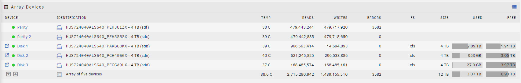

I'm new to the unraid community, still learning and trying to figure it out, so please be gentle :) I've listed my questions below but please add anything else if needed.
I've just noticed that I have some read errors on one of my drives. When I noticed I tried to run a SMART extended test (twice) but it failed in segment both times.
I have 5 x 4tb hard drives installed in my system, they are old server drives so I expected they may not be the most stable of drives so I have set 2 of them up as a parity.
1. Should I replace the drive with read errors, or perform some other tests? I have other spare drives available
2. My parity check was done 30 days ago, will this have any effect on my rebuilding the cache

That disk is failing the SMART test, so it should be replaced.
