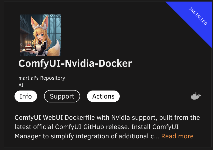

ComfyUI is a Stable Diffusion webUI.
Since a Flux example was recently added, I created this container builder to test it.
As I built it with support for specifying the UID and GID, I made an Unraid version :)
2024-09-02: Approved for CA :)
After installing the tool from Community Apps, and letting it run for the first time (to install all the required python packages), please restart it.
This is needed to tweak settings for ComfyUI Manager to allow missing nodes installation.
The source code is public and can be found at https://github.com/mmartial/ComfyUI-Nvidia-Docker

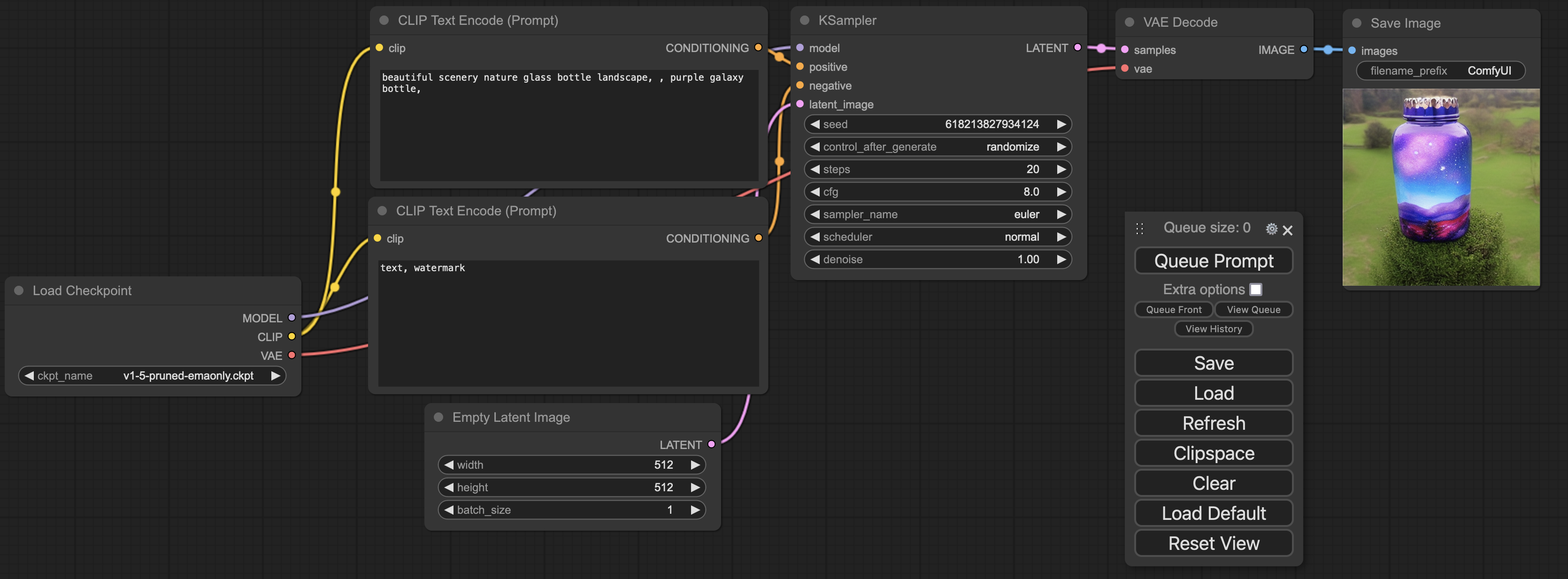

----- First run
The first time you use the WebUI, you should see the bottle example.
This example requires the "v1-5-pruned-emaonly.ckpt" file.
It is available, for example, at https://huggingface.co/runwayml/stable-diffusion-v1-5/resolve/main/v1-5-pruned-emaonly.ckpt
The way to get the WebUI to see if is first to put it in the models/checkpoints folder:
cd /mnt/user/appdata/comfyui-nvidia/mnt/ComfyUI/models/checkpoints
wget https://huggingface.co/runwayml/stable-diffusion-v1-5/resolve/main/v1-5-pruned-emaonly.ckpt
After the download is complete, click "Refresh" on the WebUI and "Queue Prompt"

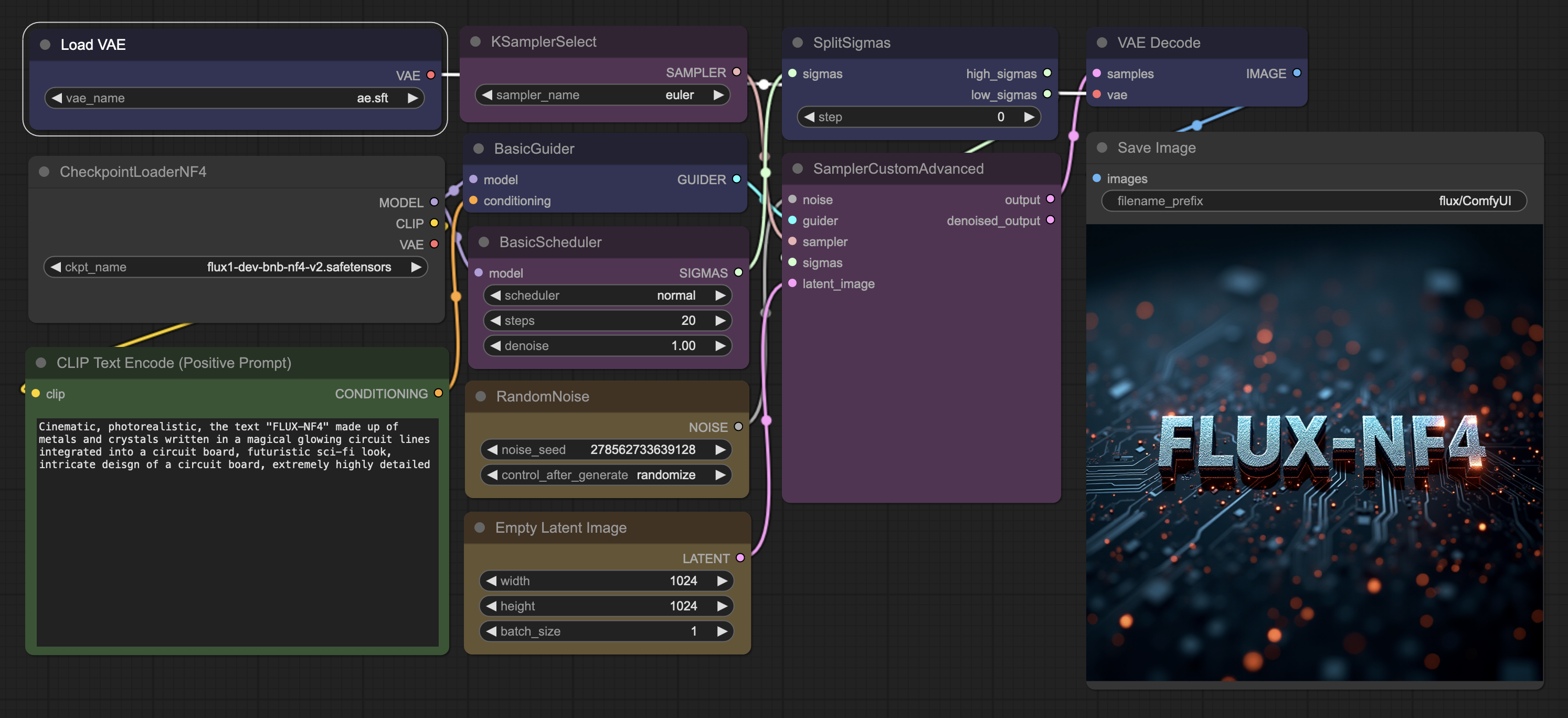

2) Start installing the NF4 requirements:
- Either click on the icon in the Docker tab and use the "> Console" (I recommend making sure the "Shell" is "Bash" from the "Edit" option) before that, or from a shell on your Unraid system find the name of your Comfy container (docker container ls); In general, it should be ComfyUI-Nvidia-Docker. If that is the case you can copy/paste: docker exec -it ComfyUI-Nvidia-Docker /bin/bash
- once within the running container, activate the venv: source /comfy/mnt/venv/bin/activate
- your terminal will now show a (venv) before the rest of the prompt
- we can install everything we want at this point, it will end up in the venv: pip3 install bitsandbytes
- verify installation if you want: pip3 freeze | grep bits
 returns bitsandbytes==0.43.3 on my system
3) Install the node itself (since I did 2 first, mine said bitsandbytes was already installed, but it installed the node):
- From Manager, select “Custom Node Manager”
- "install from Git" and give it the URL: https://github.com/comfyanonymous/ComfyUI_bitsandbytes_NF4.git
- after success, restart and reload page
Double-clicking on the canvas and searching for nf4 shows a new entry with NF4 in the title
Might have to restart the UI a couple times ... per the log, the first time it was complaining bitsandbytes was missing and after the second ComfyManager restart it installed it
4) Grab weights (they go in checkpoint, not unet)
- In the `docker exec` terminal:
cd /comfy/mnt/ComfyUI/models/checkpoints
wget 'https://huggingface.co/lllyasviel/flux1-dev-bnb-nf4/resolve/main/flux1-dev-bnb-nf4-v2.safetensors?download=true' -O flux1-dev-bnb-nf4-v2.safetensors
You will also need the ae.safetensors file
I found a test Workflow https://openart.ai/workflows/mentor_ai/flux-nf4-comfyui-basic-workflow/7QgBrjXFKDO57w0orNVc
Seems to run at 8GB of VRAM but appears to generate results :)
Edited by martial
Link to comment

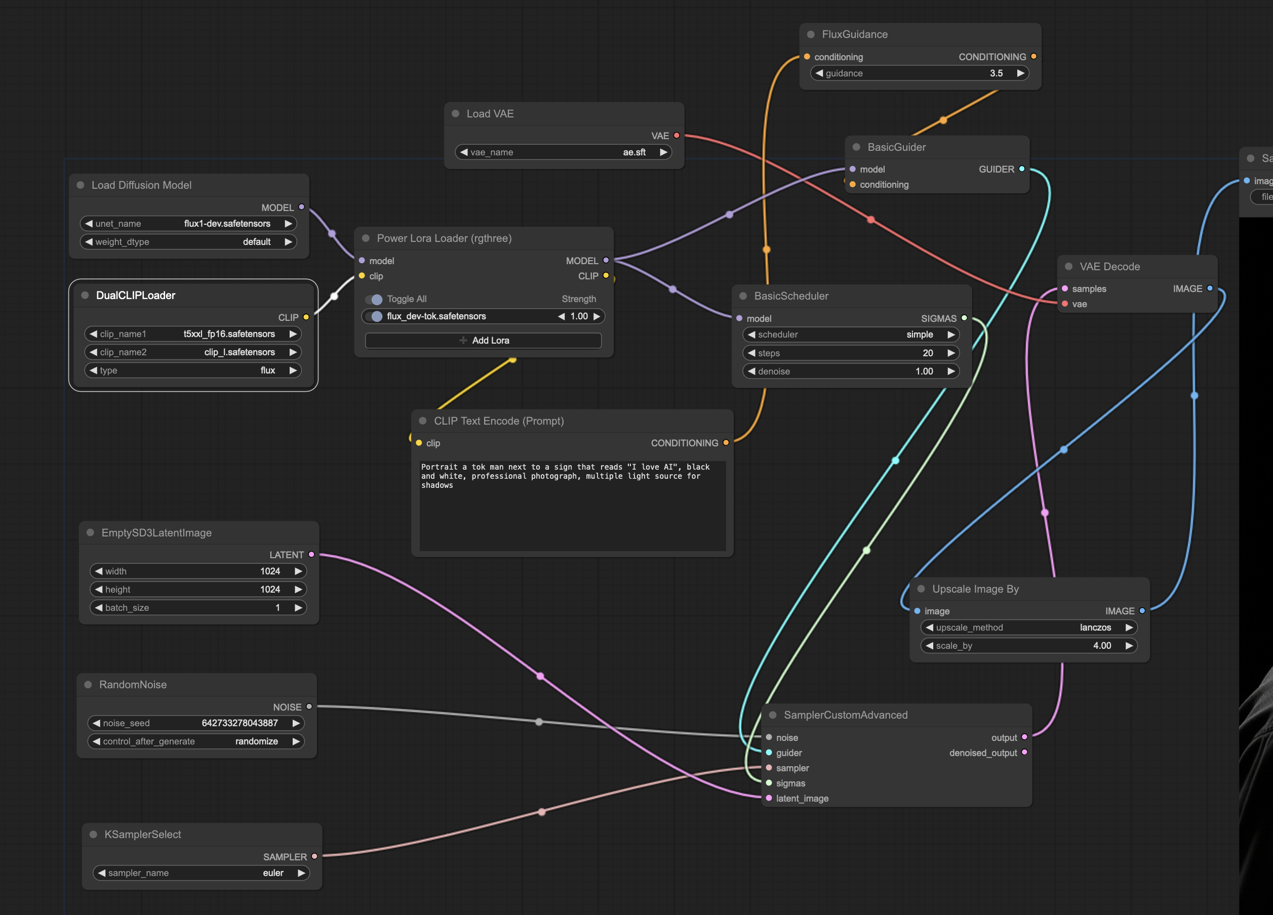

I used a custom node named "Power Lora" from "rgthree". I am attaching an image of the workflow.
The workflow itself is embedded in this image https://raw.githubusercontent.com/mmartial/ComfyUI-Nvidia-Docker/main/workflow/ComfyUI-Flux1Dev-ExtendedWorkflow.png
When you drop it in Comfy, the missing node will be displayed, you can use Manager to "Install Missing Nodes" (gotta love Manager)
That workflow was used for a Flux LoRA I trained on myself (which is kind of when I started building that container, to gain as much free VRAM as possible :) )
It is at https://blg.gkr.one/20240818-flux_lora_training/ if you are curious.
