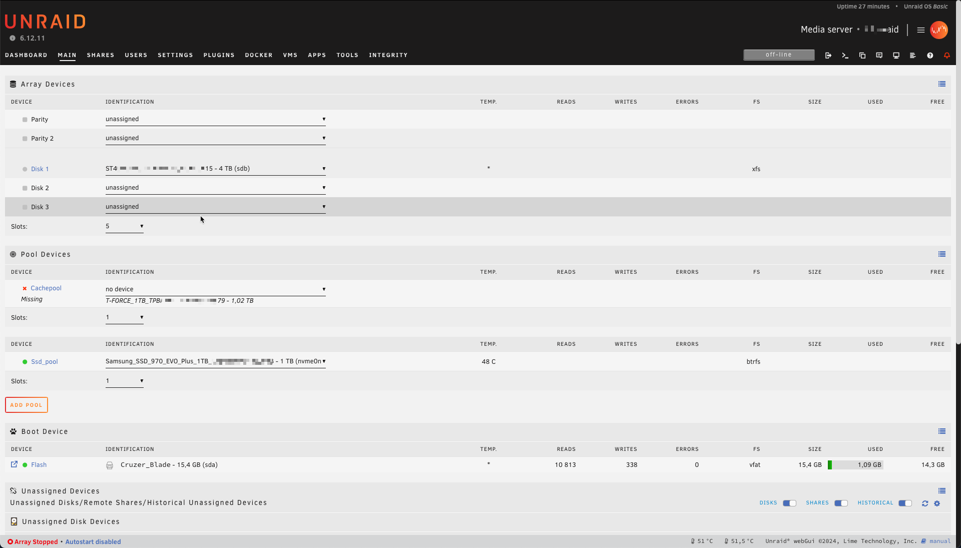

this is my first post here. Some days ago I updated Unraid from 6.12.10 to 6.12.11. After the reboot my "Cachepool" disk was gone and also not listed anywhere but in "Historical Unassigned Devices".
As another reboot did not help I did:
- remove the disk from historical unassigned devices (no idea why it was there anyhow)
- "New Config" (wrong idea?)
Anyhow I ended up having the disk removed from the System and noticed SATA cable is damaged (broken insulation at two points) so I bought a new one, but nothing changed. Connected monitor for booting to UEFI: SATA disk also not visible. External adapter on Windows & Linux machine: nothing.

Screenshot (Main) with missing disk:

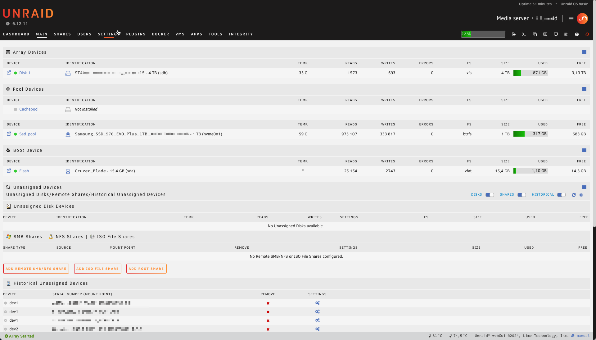

Screenshot (Main) now:

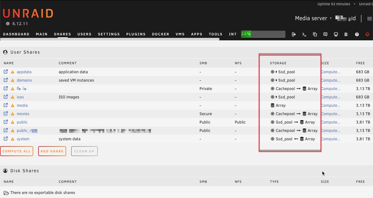

Screenshot (Shares) now:

Based on my last screenshot, can I safely assume that if there was any data on it, it was only "not yet moved cache data"?
Any way to find out when mover completed the last time?
Further question: Can I simply connect and assign a new ssd to the same slot or will Unraid get confused by this?

The way your shares are configured, it won't currently write other shares, such as appdata, to cachepool. No way to know if there was already data from those other shares on cachepool.
For example, even though your system share is configured to be kept on ssdpool, it actually has some of its files on the array. Probably created there when you enabled Docker/VM Manager before your pools were setup.
Nothing can move open files, so you would have to disable Docker and VM Manager before that share could be moved off the array.
You can
@trurl Thank you for the explanation!
So as long as all Docker/VM run fine, there's nothing else I can do probably, right?
To avoid data loss in future, might it be better to add the SATA SSD to the "Ssd_pool" where also the M2 SSD is assigned and have the pool used for Docker/VM and Cache? The SATA SSD was quite new (several month) and I already had a failed M2 some month earlier (before Unraid).
It seems the SSDs often fail completely and without warning, while I basically never had a HDD really failing completely in the last 20 years :D (just replacements because of bad SMART values)
When system share is on the array, Docker/VM performance will be affected, and array disks can't spin down since these files are always open.

My point here is that some of your system share is on the array. It is configured to be moved to ssdpool, which is fine. But it can't be moved because nothing can move open files, and these are open when Docker and/or VM Manager is enabled in Settings.
Okay, got that point now and did the following:
  • disable Docker + VM Manager in Settings
  • manually triggered the mover
  • checked computed size of system share: shows only "Ssd_pool" now
  • reenabled Docker + VM Manager
  • removed the secondary storage (Array) from system share settings
During the process I noticed that only libvirt.img seemed to be on the Array still while docker.img was on Ssd_pool already. Is it correct only these two files are in system share?
