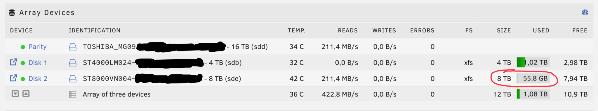

New disk in array shows with >50GB used after formatting
@itimpi Thanks for your fast answer. Did not expect that much space being overhead but on the other hand it’s a big disk
BlueGray started following New disk in array shows with >50GB used after formatting
Hello, I added a new disk to my array and UNRAID did some initialization (due to parity) but then complained that it has to be formatted first. I did this and everything seems to be okay now except that already 55,8GB are already used with no data being present on the new 8TB disk (see screenshot). Does anyone have an idea why this is the case?
