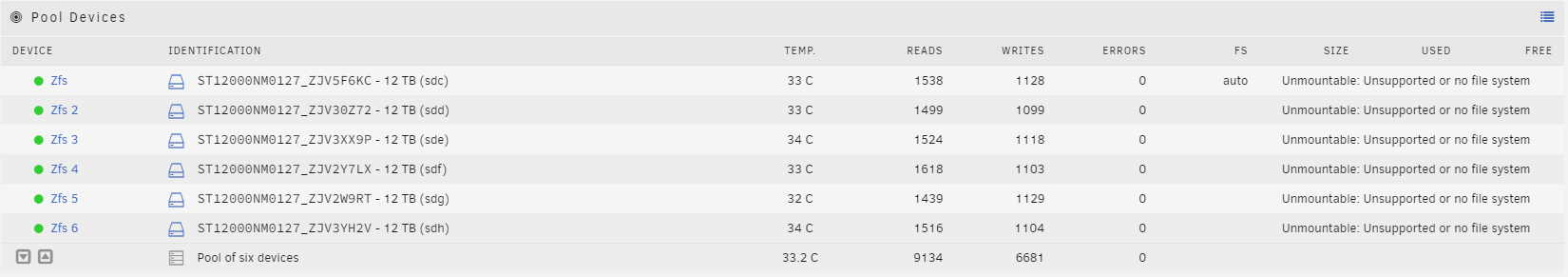

This is what the UI looks like after starting:

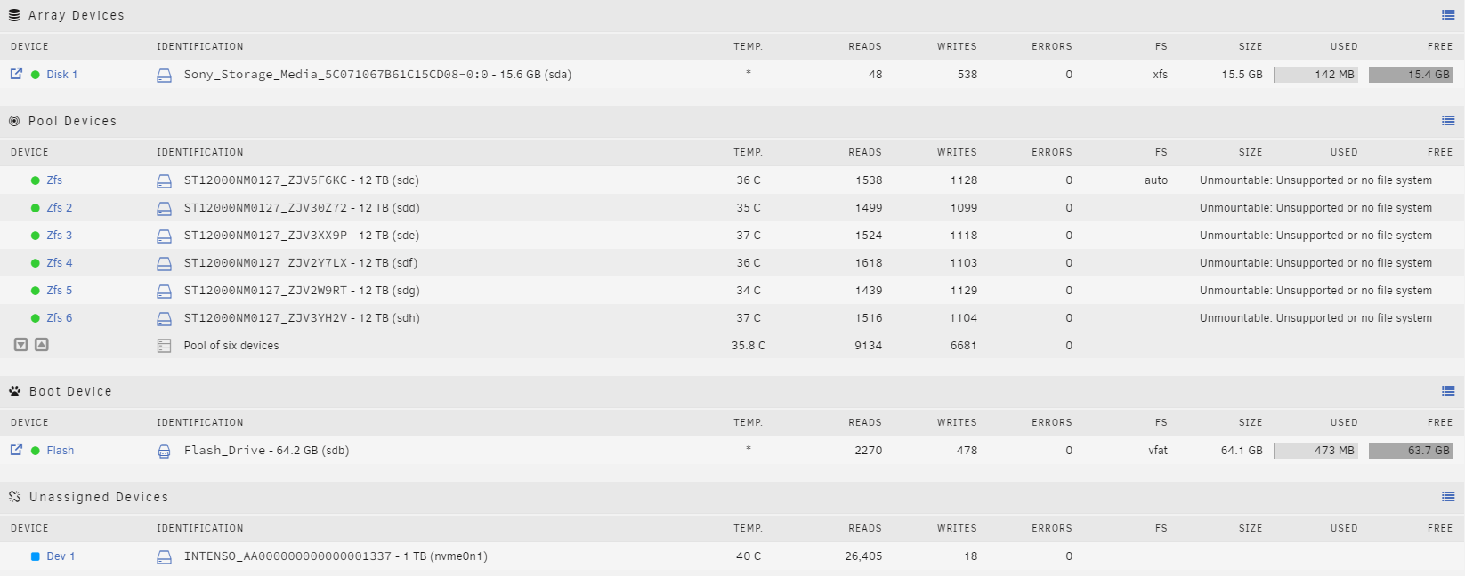

You don't have the cache vdev assigned, it won't like that, but first post the output from:
zpool status -LP

I am not sure what you mean by "cache vdev", this configuration has worked for a few months before i thought i was smart and upgraded to the beta...
Anyhow, here is the full configuration, for reference:
This is the output of the command you requested, and the output is the same with the array started or stopped:
zpool status -LP
Well, scratch that, im an idiot - i understood what you meant, and after adding the cache to the pool, everything fired right up!
