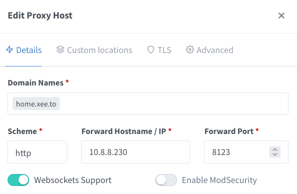

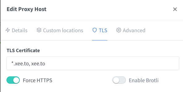

August 29, 20242 yr NPM can apply TLS to any URL. First look at how the URL is originally accessed. If it's accessed by HTTP, then in NPM you set HTTP as target along with the correct IP and port for the page/service. Assign it a certificate - that you've already provisioned - and turn on the option to force TLS/HTTPS. That's the basic amount of work you need to do for most pages. Making sure of course that you're using a FQDN and that your cert includes that name or a wildcard on the base domain (domain.tld). Some pages need more options, like websockets, header manipulation, etc. Some need additional configuration in their own settings, so keep that in mind. Some services actively block reverse proxies. The last piece of the puzzle is that you absolutely need DNS to resolve your URL - if it's an internal site, you should have internal DNS server or at least a forwarder or resolver with overrides. Unbound, DNSmasq, PiHole, AdGuard Home, others, or combination. Also, I STRONGLY recommend using NPMPlus (available in Community Apps) rather than the original NPM. For Home Assistant for example, this is all that's needed in NPM - BUT, you have to make changes in Home Assistant to allow the reverse proxy. Edited August 29, 20242 yr by Espressomatic
