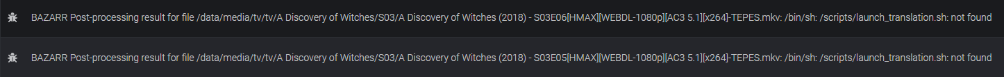

I'm trying to have my containers to execute "Post-process" scripts but they struggle to see the scripts. Here's an example with Bazarr. Im quite a newbie so I'll go through what i did step by step

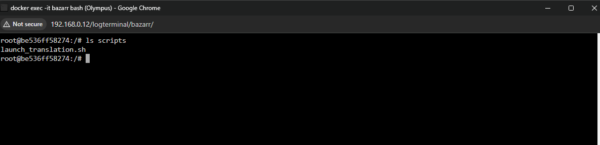

-then added a bind mount from host to container
"-v /mnt/user/appdata/scripts/launch_translation.sh:/scripts/launch_translation.sh'"
and bazarr console sees it

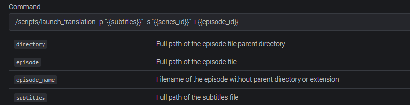

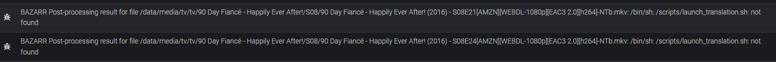

However when I add that script to the post process tab it doesnt seem to work
I put the sh extension to test it but still no luck

Might need to chmod +x the script file, or possibly investigate some other permission issue.
