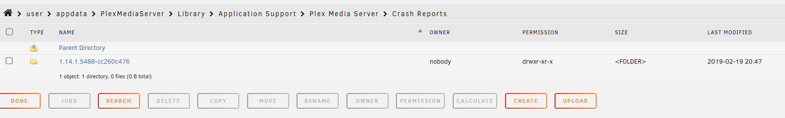

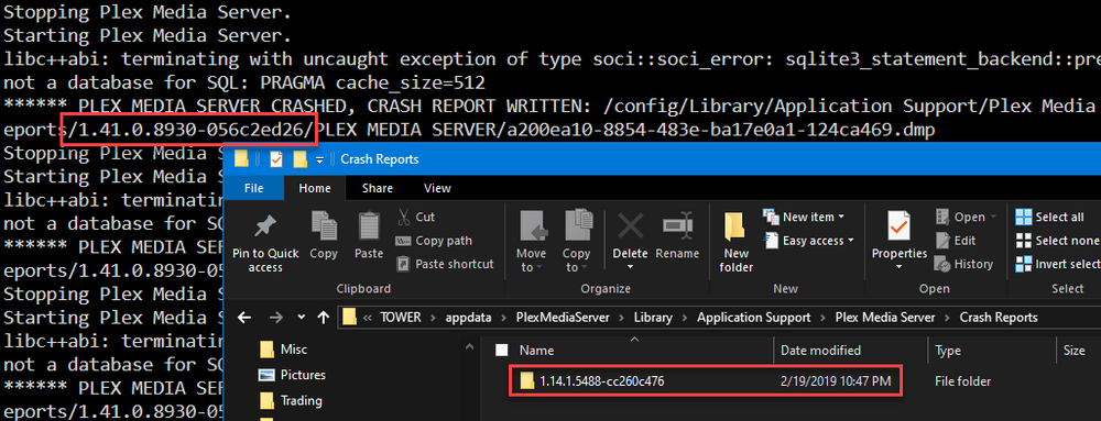

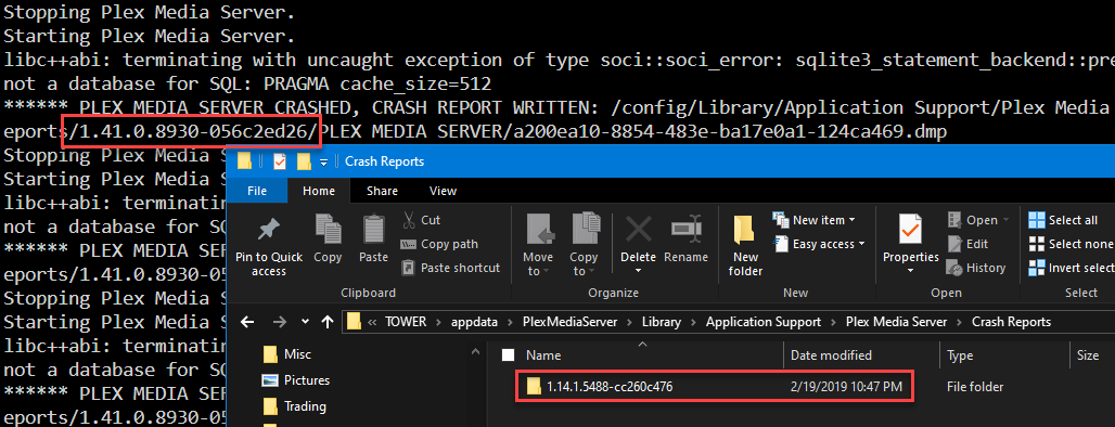

Is the Plex log you posted rhe Crash Report the log mentions? If not would help to post that as well.
@MMagTechThanks the reply. I don't see the crash report unfortunately.

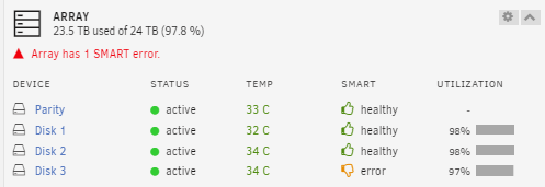

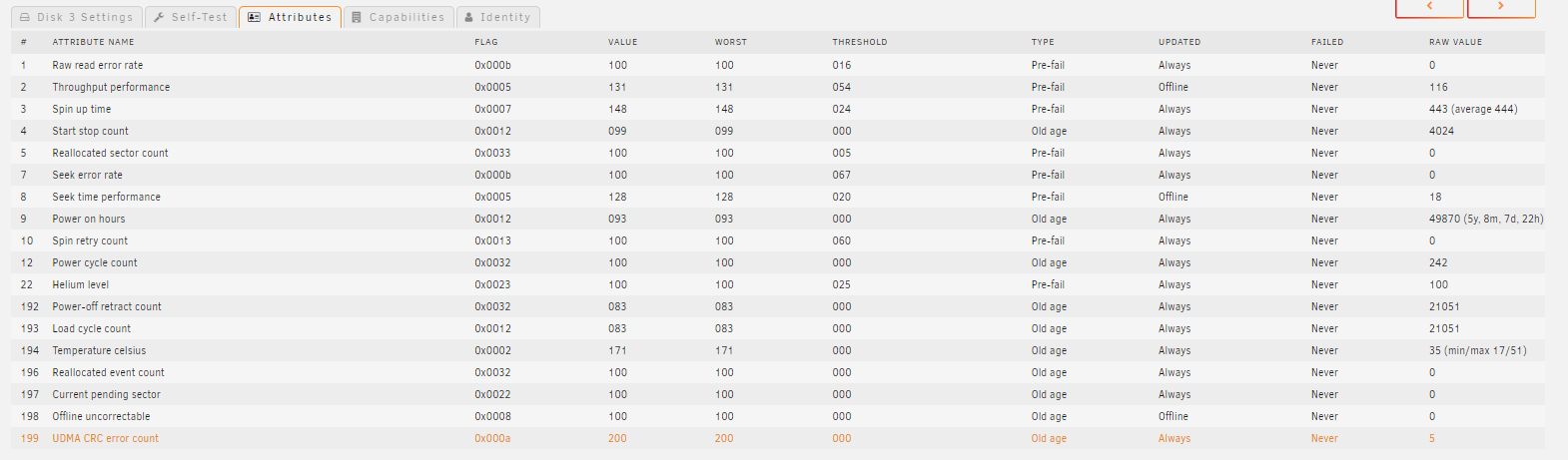

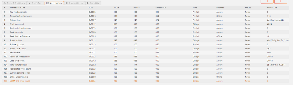

I have a SMART error on Disk 3. Not sure if that might cause something like this to occur? I cant really tell what the issue is, but it seems it is saying" Old..." Maybe I should replace if deleting Plex & rebuilding doesn't work? Thank you all again.
