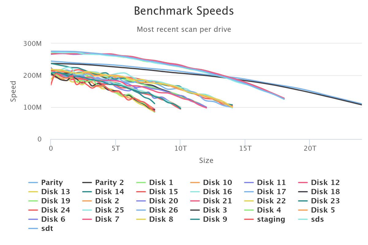

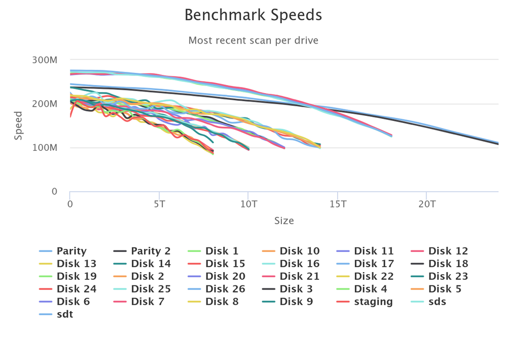

My parity sync speeds are consistently between 90-100MB/s. However, my individual benchmarked speeds are fairly close to what I would expect as shown in the graph below. Also my controller benchmarks are generally 5-10% lower than the sum of the individual speed benchmarks, which is still much faster than the parity sync speeds I am getting.
(Graph taken with 5% increment benchmarks, diskspeed default is 10%)
I am aware that parity syncs and checks are bottlenecked by the slowest drive, but even if that's the case I would only expect the 90-100 MB/s speeds toward the end of the 8, 10, 12, and 14TB disks.

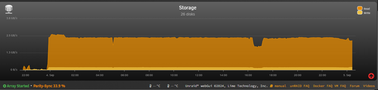

So my question is, why would my parity syncs hit a ceiling early on? I expected to see a gradual slowdown as the 8TB disks were processed, but instead it stayed steady at ~2.5 GB/s nearly the entire time.
(Parity sync, 8 TB disks ended near the end of graph, at the small bump. Dip earlier on was due to a short stint of disk reads)
Any ideas what could be bottlenecking and how I might diagnose?

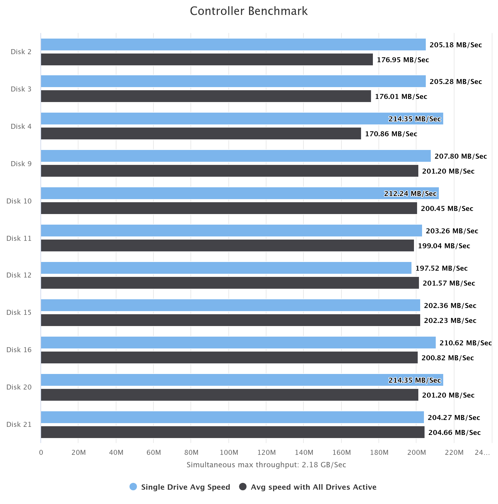

Run the diskspeed controller tests and post those.

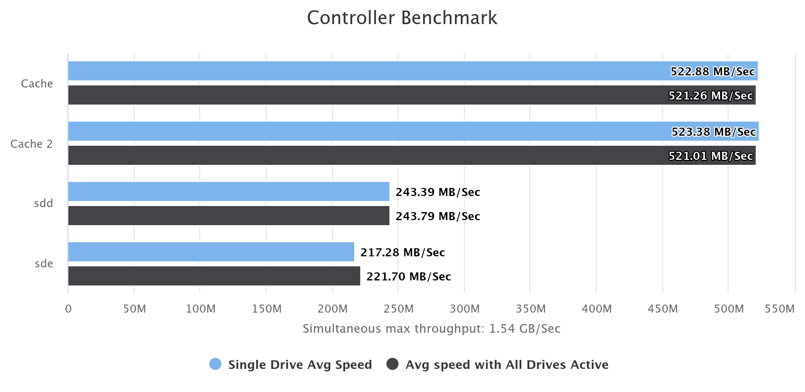

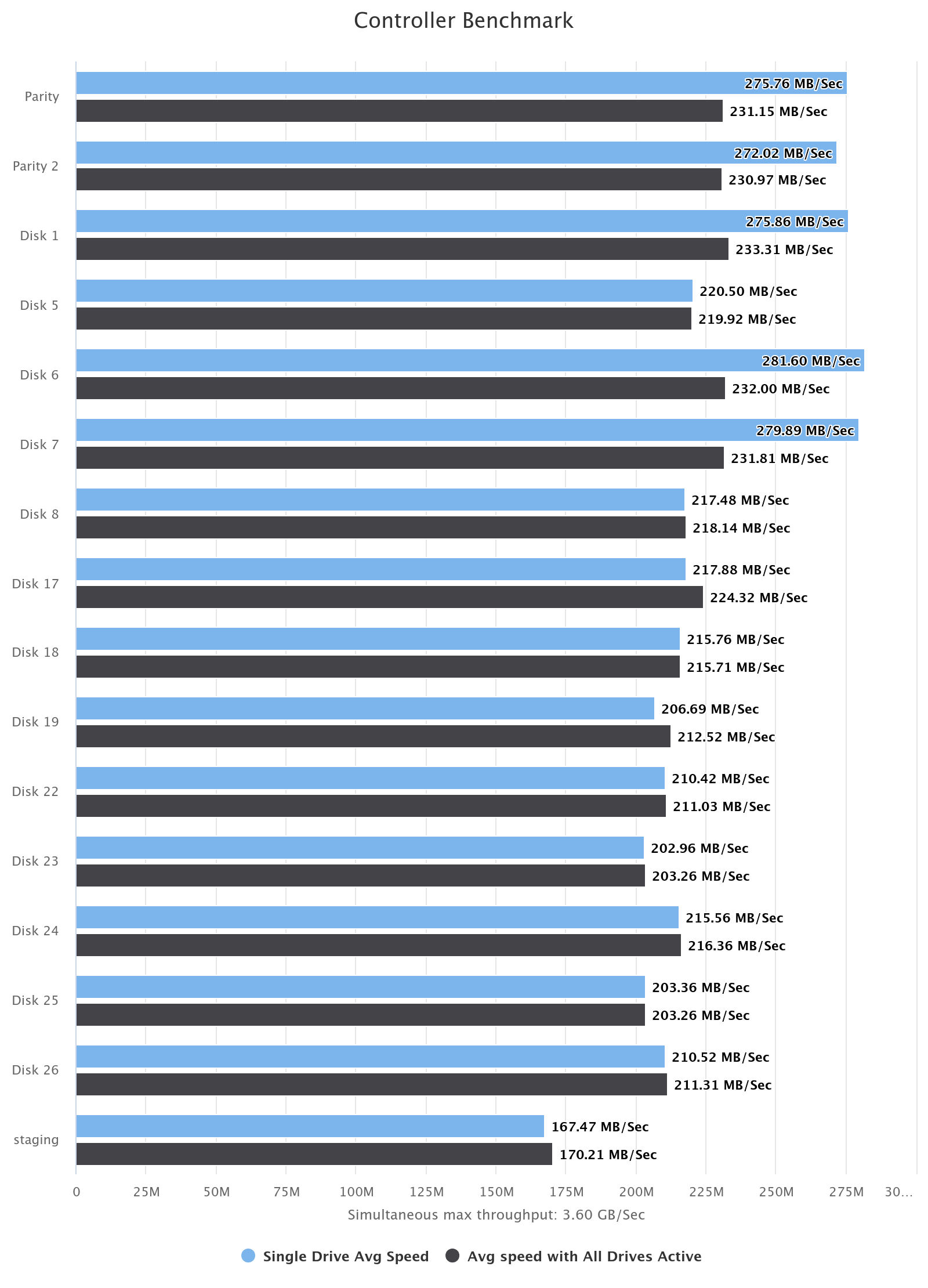

Here are the benchmarks i took immediately before starting parity sync. No drives were moved from these locations on the controllers.
controller-benchmark.thumb.png.3051a855404a0509e824cbdd542c57da.pngcontroller-benchmark(1).thumb.png.d600bd4082c12fc571a0028aabf51b2f.pngcontroller-benchmark(2).thumb.png.d17634c900c3f61d33ae133def1a597b.png
Those show a slight controller bottleneck for some disks, but not enough to justify the speed, the more drives you have, the more it will tax the CPU, parity2 also adds to that, and parity check/sync is single threaded, with 28 drives and dual parity I got around 125MB/s max with my server, never tested with Ryzen, so possibly you are just being limited by the CPU.
