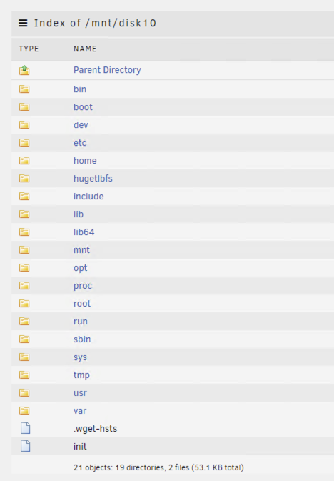

I keep having shares disappear within about an hour of starting the array. Same thing happens after reboot. After a period of time my disk10 shows the following instead of shares. Its the only disk that does this which was replaced about a month ago, but this has only started happening in the last few weeks:

The disk should be mounting now?
BTW:  The Short SMART test is not a good indicator of a disks health (although if it fails the disk definitely needs replacing).
Everything has been fine for about 3 hours now which is longest it has working in about 2 weeks. I think this has been solved. Thank you.
