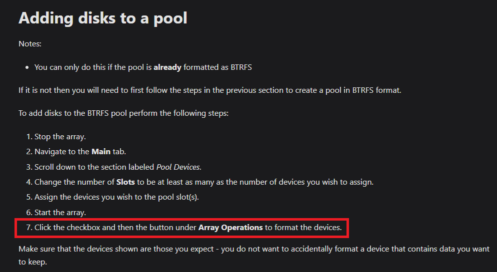

Adding disks to Pool (Multi-device pool)?
Reading thru the documentation where I couldn't perform "Step 7" because I can't find a reference to "Checkbox" ... don't see these option anywhere?

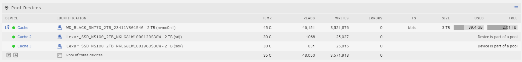

Assuming my Cache Pool is setup correctly and being used (6TB total with RAID 1 so 3TB available):

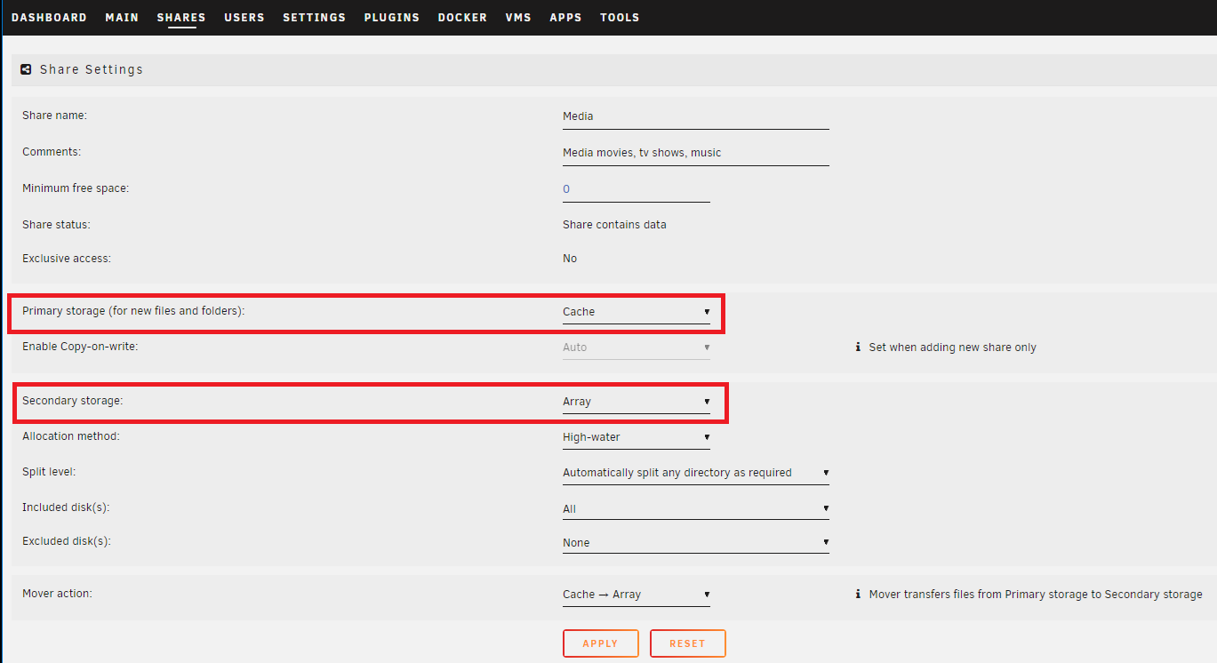

I think these are the settings I need to add my Cache Pool to my Share:
Does the above seem correct?

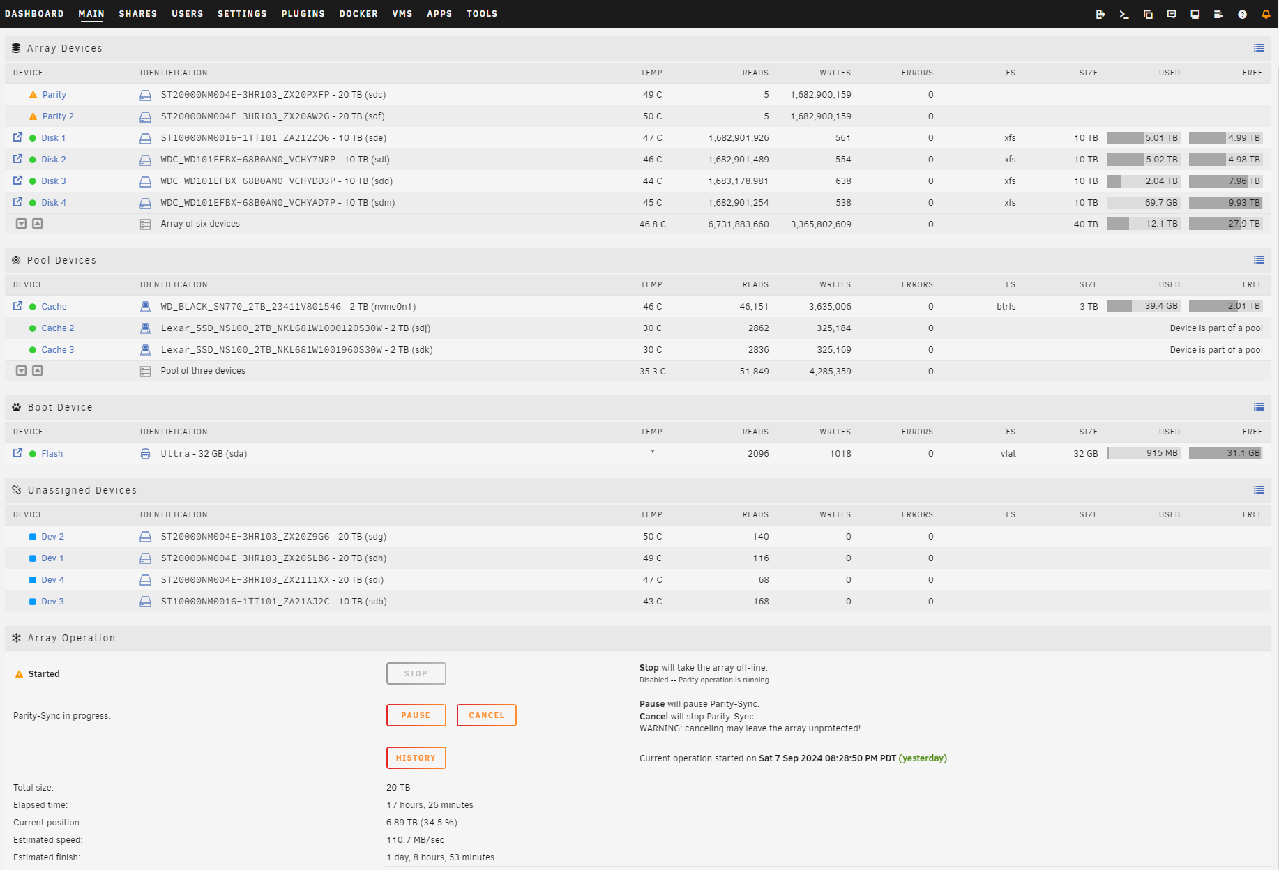

Overview, parity is updating as I swapped out 10TB Parity 1 and now using two 20TB drives for parity.  Waiting for these (2 days) to build then I'll stop the array and add 4 other unassigned drives.

You don't need to do anything in the shares page to add a pool device, just on main, change the number of slots, add a device, start the array.
