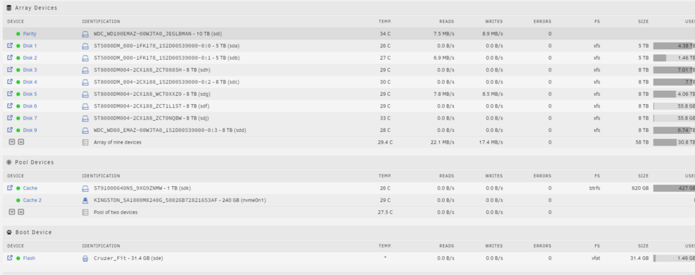

I just moved, and I was thinking that I might have had a cache drive go bad.  Mover doesn't want to move the files off, and when I view the contents of the drive, the item shows that there corrupt on a certain files, I was thinking would it be better to swap it with a new drive or do a parity check and have it fix those files?  I  tried copying over the files that open like pictures or zips, but there are some that don't, and the ones I do copy over, I delete them, but they look like they disappear but come right back when I refresh the window.  Any idea on how to move forward?

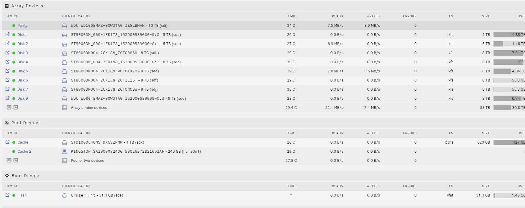

I dont see the scrub option.
That screenshot is the Main tab.  You need to click on the pool name to get the dialog to come up that offers the scrub option.

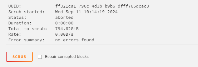

It seemed to say it ran but the duration was 0 seconds, any thoughts on what is going on?
It aborted, post new diags.
It doesn't say why it is aborting, but I would recommend backing up what you can form the pool, and then reformat.
