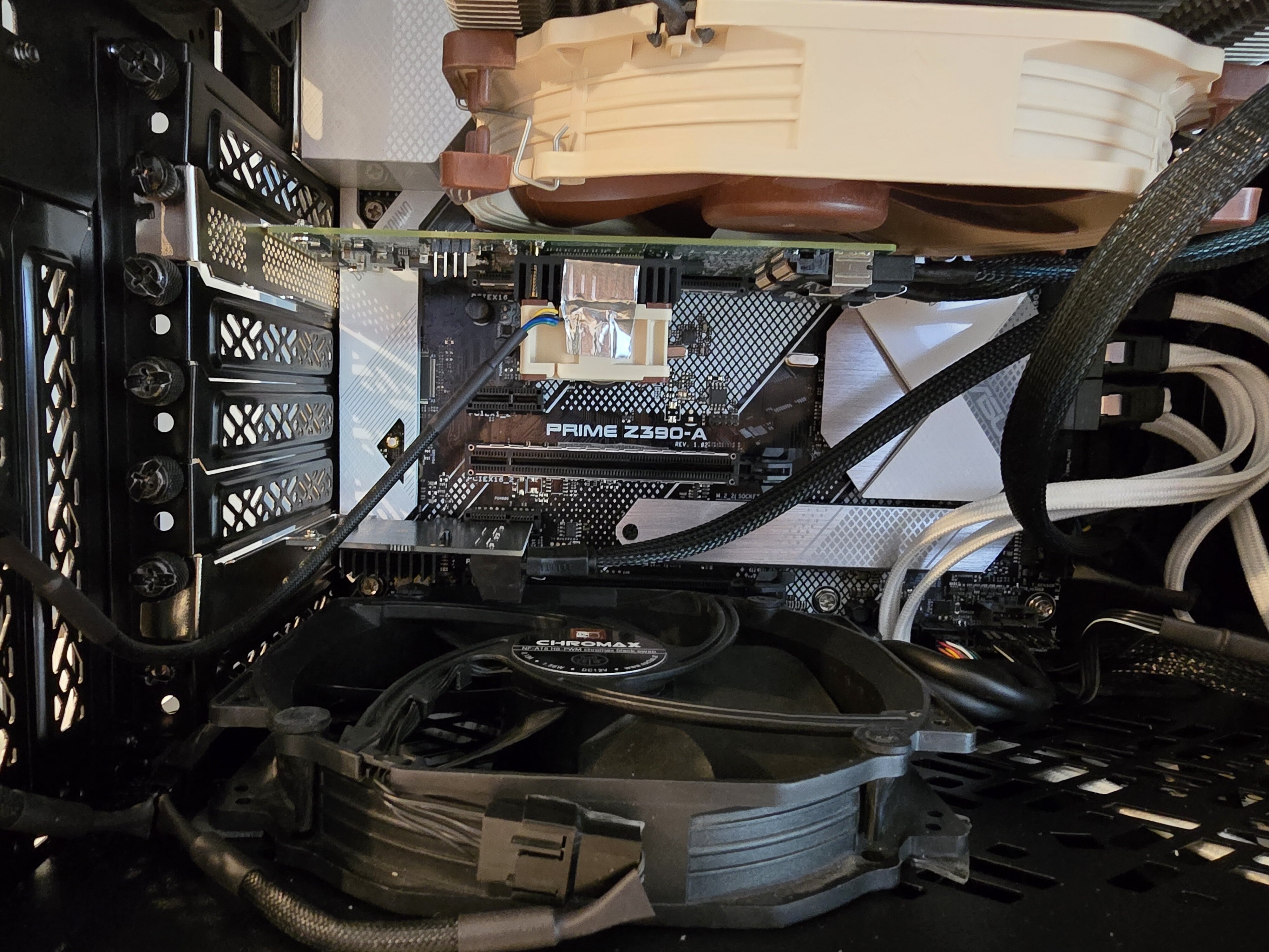

I ended up rebuilding over disks 8 & 10 without issue and my server is back online and operational.  I appreciate all of the help.  I guess my final question is do you think the airflow for the LSI card is good or should I add another NF-A4x20 over the heatstink?
Edited by clowncracker
Do you have any way to check the temperature of the heatsink in the final configuration, i.e. case closed?
I do not, maybe I should just buy the fan to be safe.  I'd rather spend $15 now then to have the card fail prematurely in the future.
I'm hoping this is good enough.
