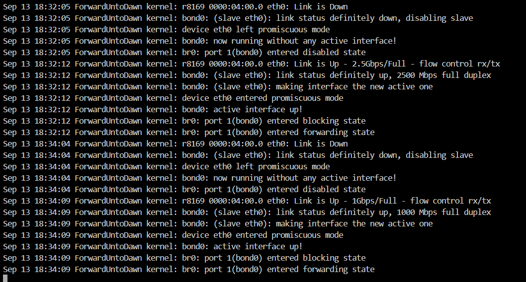

September 13, 20242 yr Author I'm not sure if this helps at all? This is what is shown when I swap from my 1gb connection on my old 1gb switch to the 2.5gb connection on my new 2.5gb switch. I can attach a graphics card to it and do what you asked earlier if it's not possible to help without it, I just have to wait for my parity check to complete in an hour or so. I appreciate the help Edited September 13, 20242 yr by Synthesthesia
September 13, 20242 yr Community Expert Not sure what your pic does show us. You've unplugged the 1G connection, put the cable into the 2,5G switch (perfectly ok and working) and a few mins later you have switched everything back. Actually does not mean anything besides that the link to the switches are both ok. btw: with "flow control" i have meant ALL devices. It is not sufficient just to turn it on on UNRAID. Usually the (managed) switch handles this, but if you have a dumb one, it just forwards the request which needs to be handled by the other side of the connection then. You need to asure that all devices play along with this. The log will tell you if flow control hits with "...entered blocking state" (resume is signaled by "...entered forwarding state". BTW2: why does it talk about "bond0" ? You surely do not want or need any bonding.

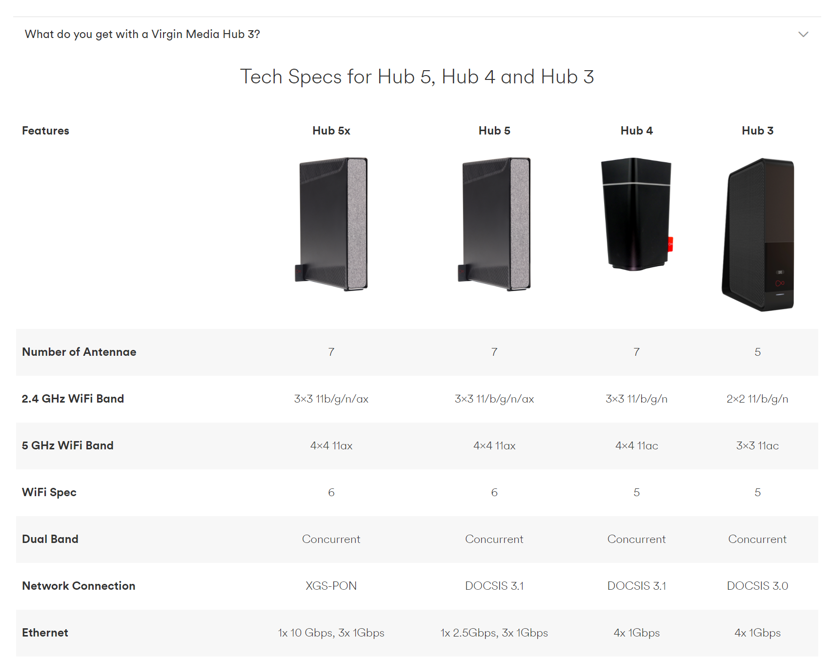

September 13, 20242 yr Author Solution I've connected the hub to a normal 1gb port on my router (virgin hub 5) and it works, it says 2500mb on unraid too. So it seems like for some reason the hub doesn't want to accept the switch over the 2.5gb port even though it works fine connected to my PC. Hm. Not an unraid problem though so I'll mark it as solved. Thanks for the replies trying to help guys.

September 13, 20242 yr Community Expert but, even with a working 2,5 connection to that single port of "hub5", you won't see any difference or improvement. The internet connection is limited to 1G download (DOCSIS3.1 cable), so there is no benefit for using the 2,5 port at all. Correction: OOOPS! It MAY improve the LAN access to unraid. So 2 clients with 1G could download from UNRAID at full speed (theoretically). Edited September 13, 20242 yr by MAM59
September 13, 20242 yr Author My internet is faster than 1gb, it's like 1170mb, so with 2.5gb I get that full speed, without I get 990mb or something. Not a huge difference but I'd like to get what I'm paying for from my devices
