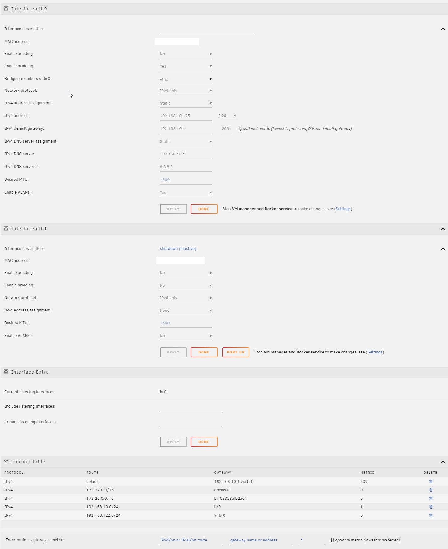

I do not see in the setting a way to set the rules that will force a Adapter/Mac to use eth0.  Below is my network settings with one USB adapter connected after boot.  If I boot with USB network adapter connected but no cable it will not ping 192.168.10.175 which is the MB ethernet adapter always connected.
Edited by jzhvymetal
It is listing the MAC's....I just block out the MAC addresses. The problem is that if I boot with the USB Ethernet adapter with cable connected to main LAN, it will ping 192.168.10.175, but the web interface will no longer work, and SSH will be unavailable. Additionally, the main Ethernet adapter will not receive an IP address from my DHCP server. This locks me out because the graphic adapter is dedicated to a Windows VM, so once fully booted, it will not be used for the console. The only solution is to remove all USB Ethernet adapters and reboot. The USB adapters are connected via a USB hub that is normally passed to the Windows VM when fully booted. The USB adapters are not always connected. They are used for IT work on other devices using a different LAN's.

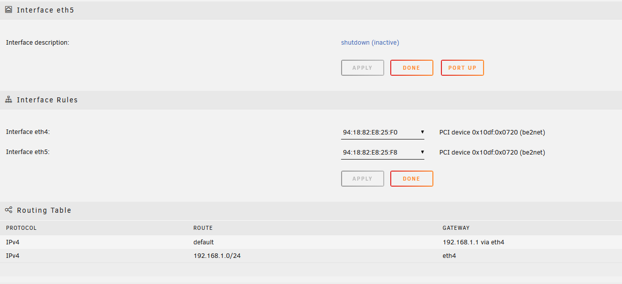

You are missing the interface rules section, like this:
Could it be that it does not show when not booted with 2 nics?   I can not get access when usb nic are connect as described above.  I can only add the usb nic after it boots.   Is not the interface rules only created when it detect more than one nic at boot?  It there way to force the interface rules always when there is even one nic?
