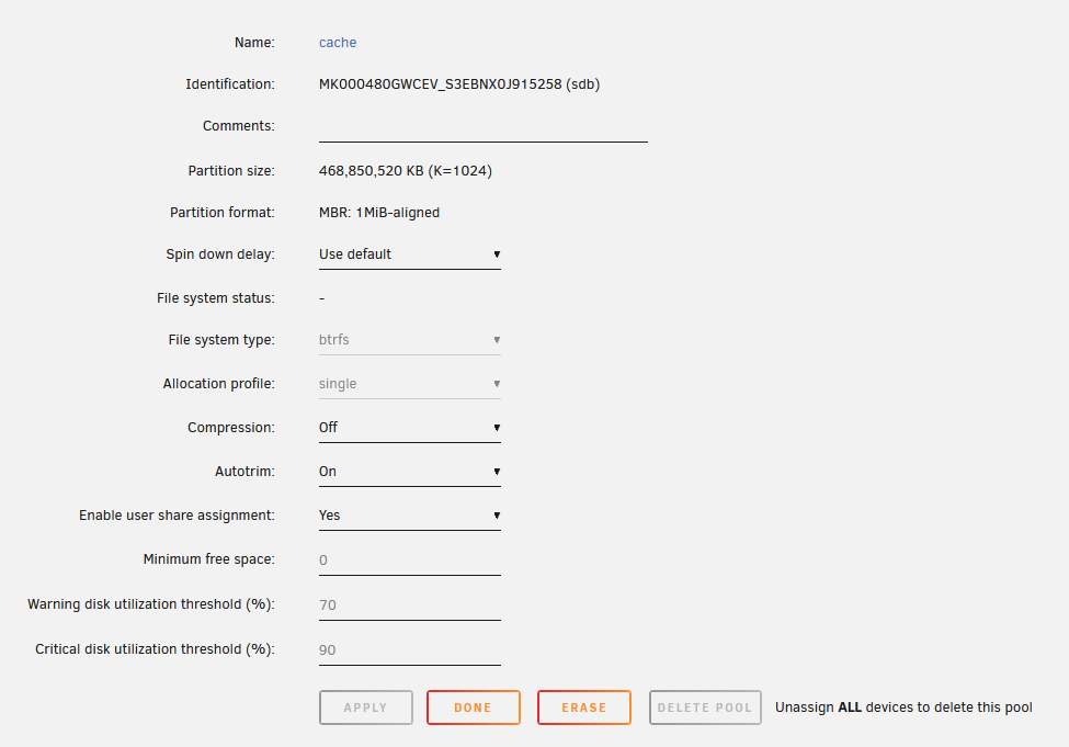

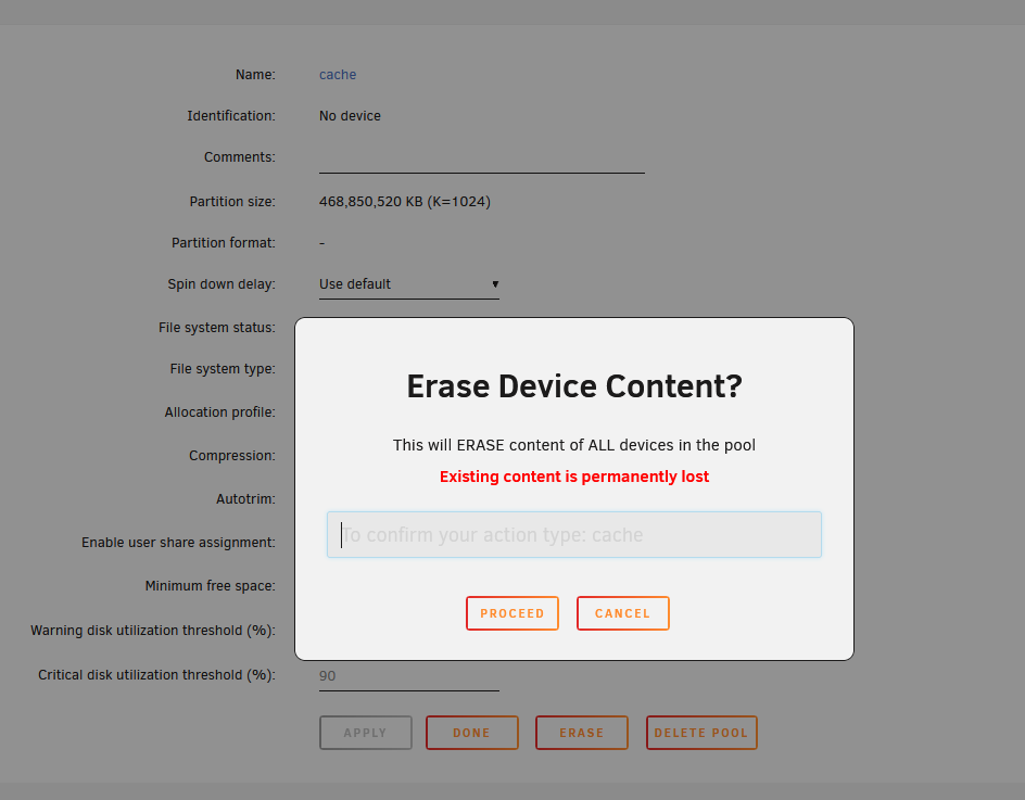

September 19, 20242 yr Author So I have managed to get my server up mostly from a backup, however, my drive setup wasn't stored, I have that, so that's OK but the cache is defaulting to BTRFS whereas I was using a pool of 2 drives on ZFS, I can't seem to change it from BTRFS to ZFS though and I'm worried about changing something wrong and deleting what's on the disks, if anyone can help? Looking in my new disk.cfg I can see disks are marked btrfs but not sure if I can just change this if I can work out which disks the cache ones are and just set zfs? diskFsType.7="btrfs" Though based on these numbers I feel these are just the hard drives and not the SSD cache drives. I also had an idea to start the array without the cache drives, mount them as unassigned devices and then copy the contents off, and create the new cache pool but I cannot start the array like that and I'm worried that erasing the "cache settings" will erase my disks even if they are unassigned I get this warning Edited September 19, 20242 yr by J89eu
September 19, 20242 yr Author Ok resolved that, I need to just create a new disk config, now back up and running, thanks all
