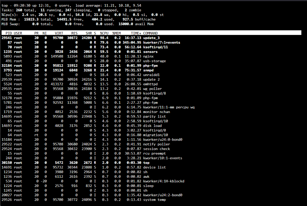

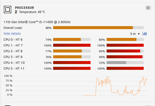

Hi all, just branching this off from the 6.12 release. Since updating my system performance has gone insanely bad, to the point the web interface is not usable if I perform a simple task like erasing a drive... I've been talking about this loosely in the Unraid discord but seems no one is able to really concentrate on the one issue to help, and I get that, there's a lot of people asking questions that overlap, it is what it is. So I updated from a working system, no pre-existing issues. I then noticed my server seemed dead on first boot, no screen output, no ping etc, but I had to go for lunch, when I came back it was up and working. Logged in and then went to set up my cache from btrfs to ZFS and this is when I noticed these huge pauses. To cut a long story short, I have no VMs, no docker containers etc running. System is an 11400 Intel so not old nor underpowered for the task at hand! Attached CPU usage when just asking it to format a drive, being the first peak (set to 5M) and then after startng the array with also the TOP output from console. Diagnostics also attached. I have also updated my BIOS since having the issue, diagnostics are from before this. I've also recreatd a fresh USB image and transferred over my config, same issue. I have tried safe mode with no GUI and plugins, issue remains. Downgrading to 6.11.5 immediately resolves the issue. atlas-diagnostics-20230619-0928.zip

Hi all, since updating my system performance has gone insanely bad, to the point the web interface is not usable if I perform a simple task like erasing a drive... I've been talking about this loosely in the Unraid discord but seems no one is able to really concentrate on the one issue to help, and I get that, there's a lot of people asking questions that overlap, it is what it is. I'm happy to separate this out to an entirely new thread if needed... So I updated from a working system, no pre-existing issues. I then noticed my server seemed dead on first boot, no screen output, no ping etc, but I had to go for lunch, when I came back it was up and working. Logged in and then went to set up my cache from btrfs to ZFS and this is when I noticed these huge pauses. To cut a long story short, I have no VMs, no docker containers etc running. System is an 11400 Intel so not old nor underpowered for the task and hand! This is the CPU usage when just asking it to format a drive, being the first peak (set to 5M) and then after startng the array with also the TOP output from console. Diagnostics also attached. EDIT: To add I just downgraded back to 6.11.5 and all my problems disappeared to this seems to be an issue specific to 6.12 for me atlas-diagnostics-20230619-0928.zip

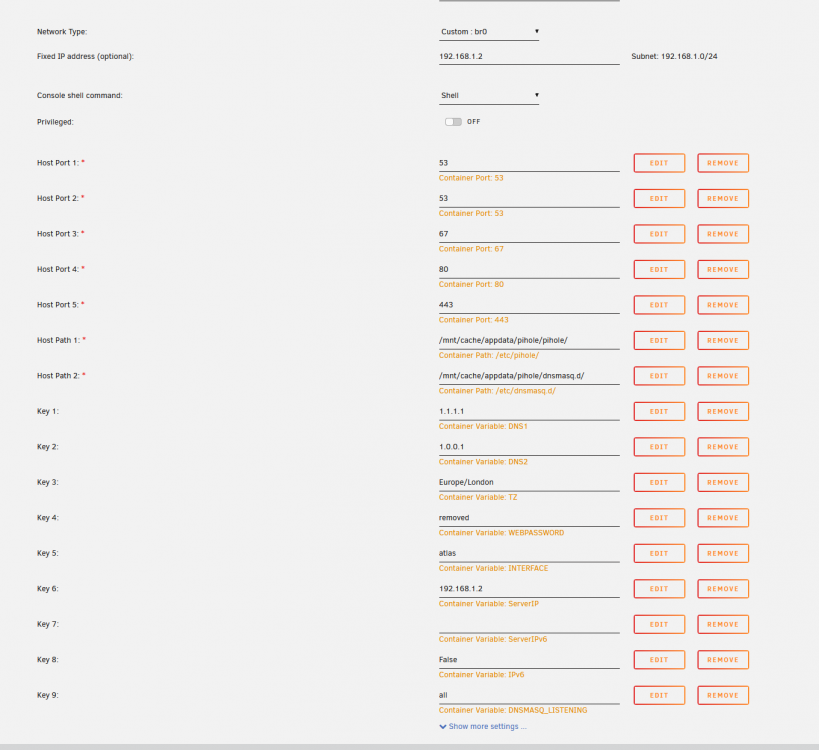

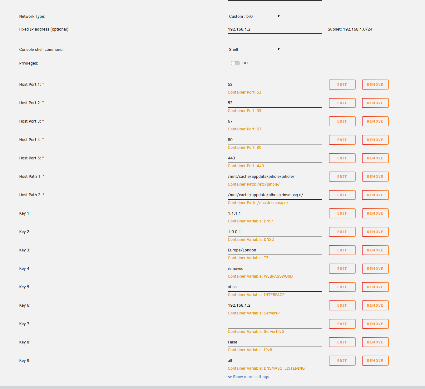

Hi all I was having an issue with the docker losing all stats when a setting change was made, I had this with the Unifi docker and it was caused by the interface settings. I noticed that I was not running this docker on my custom interface so I swapped to that but it wouldn't start, I managed to get it working using these settings: "Network type" I had to keep as br0 rather than my custom interface called "atlas" but I was able to get it started by settings the INTERFACE as "atlas" and the "ServerIP" as the custom IP I wanted, does that look right? Hopefully it will fix my stats being reset each time too.
