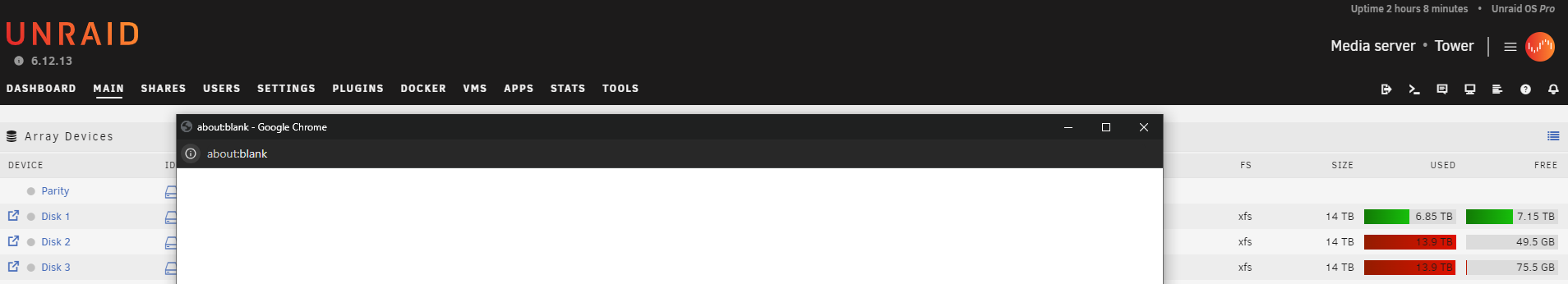

I can't get a command prompt, see the log file etc. unless I'm using the web version.  Pulliing up the log is a blank screen and I'm guessing all commands except reboot and shutdown do nothing as well. I discovered the problem when I couldn't delete a Wireguard tunnel.
Here's what the log file looks like through local GUI with Array started (same if it's not started though):
As noted, I can't run a diagnostics either unless I use the https://connect.myunraid.net site.

So the problem is the terminal window not working?

That’s just one example. No terminal window, log or commands get executed when I click them from local gui. They only work from the online management gui.
Try booting in safe mode and see if the terminal works, if still not try a different browser.

So it seems to be tied to one browser on one WIndows PC on my network. Browser is Chrome and PC is running WIndows 10 22H2. Chrome is logged in with my Google account so settings should be shared across platforms. I have another Win 10 environment (running in a VM on the Unraid server) that is working fine with Chrome. Any thoughts?
EDIT: Just checked safari as well from my phone and it's working correctly. Also, the PC was working fine and then stopped all of the sudden (that's why it took me a while to figure out what was going on with my server). Some settings in the browser are managed by group policy but I have no idea what might be affecting this behavior since I can reach the server fine (ie firewall).

If it's just that PC you could try uninstalling Chrome, then wipe all the leftover directories, then re-install it, if that doesn't help, you may need to re-install Windows.

Thanks for the help. Restarting the PC (and installing some Windows updates) seems to have fixed it for now. I'll report back if the issue returns or mark as solved. Thanks again.
