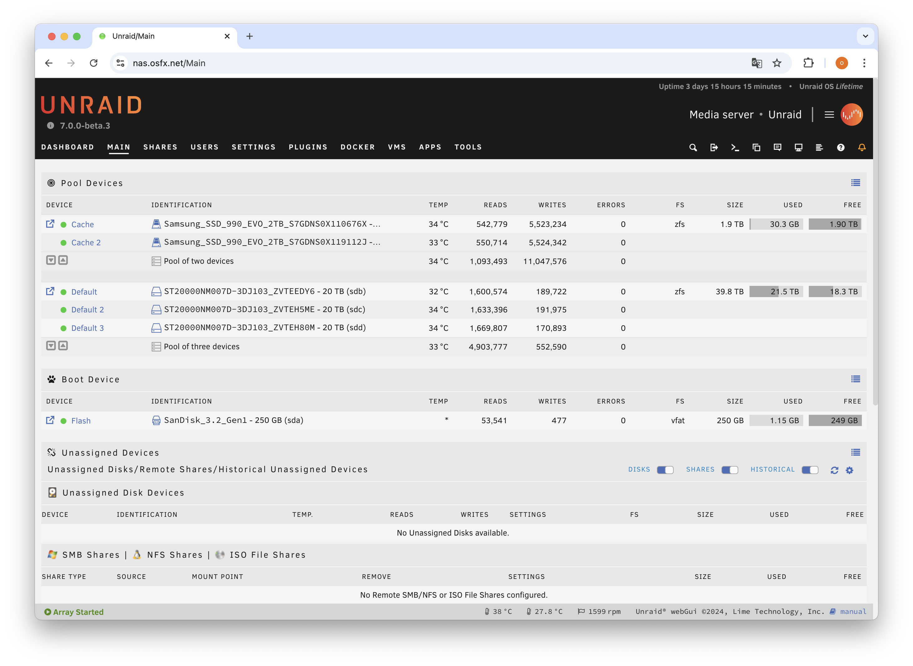

Okay, today is the day where I will sell my current NAS which is still running my RAIDZ1. As I don't have my new hardware yet (it will come next week hopefully) I am a bit nervous to not loose data. That's why I just wanted to make sure that I won't miss anything. So here's what I am running currently:
I'm running Unraid 7 beta3. I have two ZFS arrays: One mirrored Cache and on RAIDZ1 array (please see screenshot).
If I understood it right I just do the following:
  1. Stop the arrays
  2. Shut down the system
  3. Uninstall the harddrives and remember the order of them
  4. Reinstall Unraid on the new system
  5. Add the drives and the Cache
  6. Create a new Cache pool with two devices and a new RAIDZ1 with three devices and then add the drives in the order that they were before
Then Unraid should show me all my data as it was before?! Sorry for this stupid question and my ask to reconfirm the process but it just sounds too easy... I thought there would be something like a "recover from old pool" process or something like that.
It is not even as difficult normally as the steps you posted 😀
You should be able to simply plug the existing drives into the new system and then boot from your current flash drive and everything come as it was before.   Only if that does not work is there anything more than that involved.
