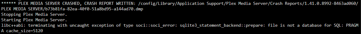

My Plex Media Server seems to have issues and I'm out of ideas on how to resolve.
When I try to open the WebUI from Plex App in Unraid I just get:
This just started happening, no idea why, was in the middle of doing a MetaData update (via Plex WebUI) and suddenly these issues?
I tried uninstalling and re-installing Plex Media Server, but same issue?  (although not entirely sure the uninstall/reinstall cleared out prior config/settings).
Check permissions and all is good, so really have no idea what this is about?  "sqlite3_statement_backend::prepare: file is not a database for SQL: PRAGMA cache_size=5120" ??

Ok, I believe I’ve managed to discover the issue.  I had installed Unassigned Drive plug-in which seemed ok, but then it showed “reboot” on one of my external HDD USB drives … doesn’t seem to like having two external USB drives … not really sure, but it triggered a reboot grayed out button under the Unassigned Drive list for one external HDD?
When that happened (I just noticed now) one of my SSD drives that made up 3 drive Cache (2 SSD and one M.2) disappeared.  AppData is setup to use Cache to Array as well as Media share that is used by Plex (both used by Plex).
After 2 weeks of finally getting all my data transferred over to Unraid, I noticed an Unraid update, so let that install this morning and did a reboot … this is when I noticed my cache SSD was set to unassigned and I re-added back to my Cache array.
So I suspect Unassigned Drive plug-in “may” have been the source of this.
