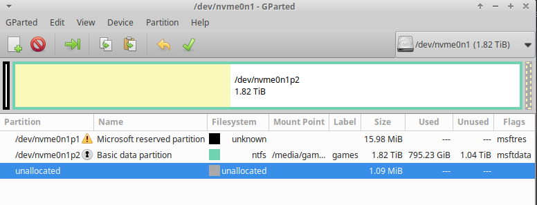

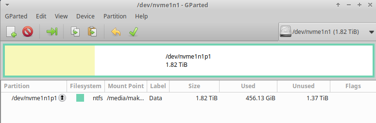

Perhaps the gparted images will help?
Edited by makem

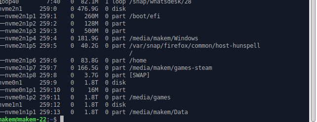

added edited lsblk output
Not really, since that device is not being detected in Unraid.

Yes Ubuntu can mount NTFS as shown in the screenshots above.
