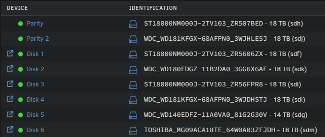

The drives in my system are as below:
If the number didnt grow to large I initially thought best thing to do is do another run and write the corrections this time, but upon reading further mostly on here it seems this is not the best idea since I could then be writing trash to my parity drives.
Not sure if better course is to shut the machine down once this run completes and do another run to see if they clear themselves.
