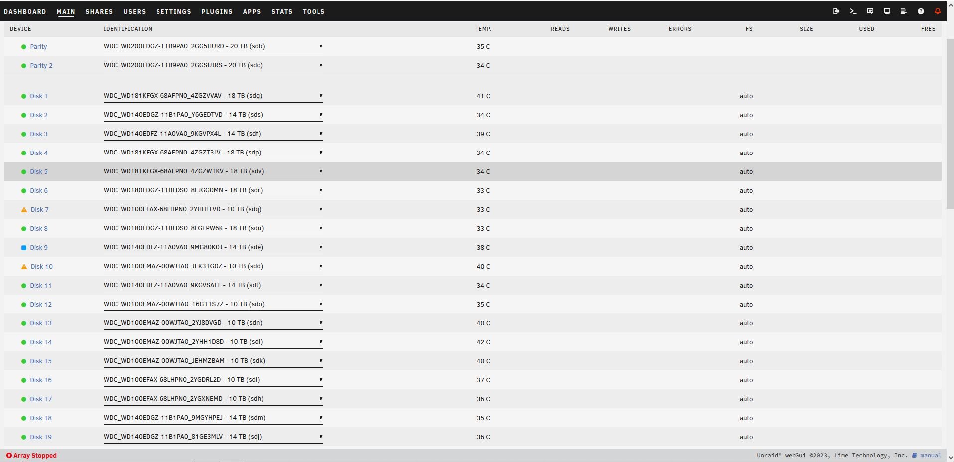

Yes, 7 and 10 are now back to the original 10TB drives, was trying to upgrade them to 18TB drives. Disk 9 is a 14TB that started throwing read errors shortly after the rebuild started. One suggestion was to create a new config, which is when disk 9 showed up as new.  It was strange too because initially Unraid marked it disabled and emulated which gave me three drives in an emulated state, which shouldn't be possible with just two parity drives. After trying a new config, disk 9 when to new and Unraid said it then had too many wrong or missing disks. The data on the disks should still be valid, so if I could somehow get Unraid to accept the current configuration, I would think that I could rebuild parity based on the array disks. Attached are screen shots of the array before the upgrade, and the current state.
Ahh, so you have already done a new config? Some info is missing, since if you are using the old disks 7 and 10 they should show as wrong, not as invalid, but showing as invalid also suggests that you started rebuilding them and then canceled/aborted, it's important to know what exactly happened, or the advice can be wrong.

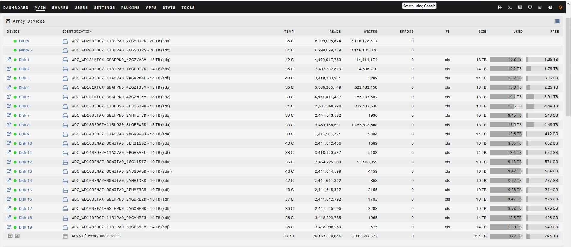

Did a new config and all drives show up as new. Started the array and it's rebuilding parity. I'll report back when it's complete, probably 3 days...
Are all data disks mounting? You can also post new diags.
The rebuild finished, and so far everything looks ok, but I haven't had much time to take a good look.  For some reason, I'm not getting the status email I used to twice a day, don't know what would have changed there.  I tried the test button, but nothing came through, something else to look at...
