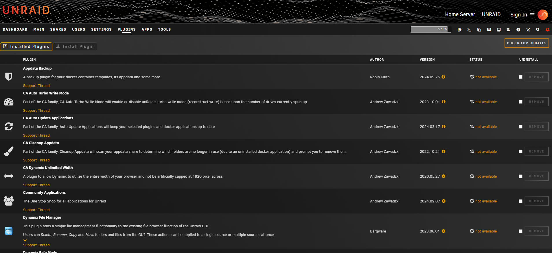

All of my plugins are unavailable, and I cannot access the App Store.

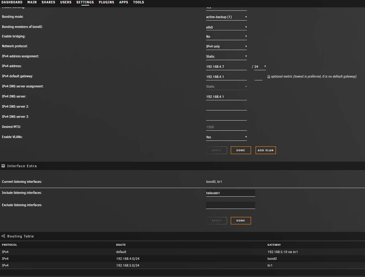

My current subnet is set to 192.168.4.1, but when checking the network settings, I noticed the old subnet 192.168.5.1, which was associated with an unplugged USB dongle (identified as eth1).
Upon booting, I see logs showing that the OS is still trying to find 'eth1'. One specific log message states: "Device 'eth1' does not exist."
It seems that unplugging the USB dongle may have caused this issue, but I’m unsure how to proceed.

You can delete/rename /boot/config/network.cfg and network-rules.cfg to go back to default DHCP LAN settings, and if you still have connectivity issues after that, bypass pfSense and connect the server directly to your router, to see if that is the problem.
THIS !!!! worked for me. Thank you very much !!!
