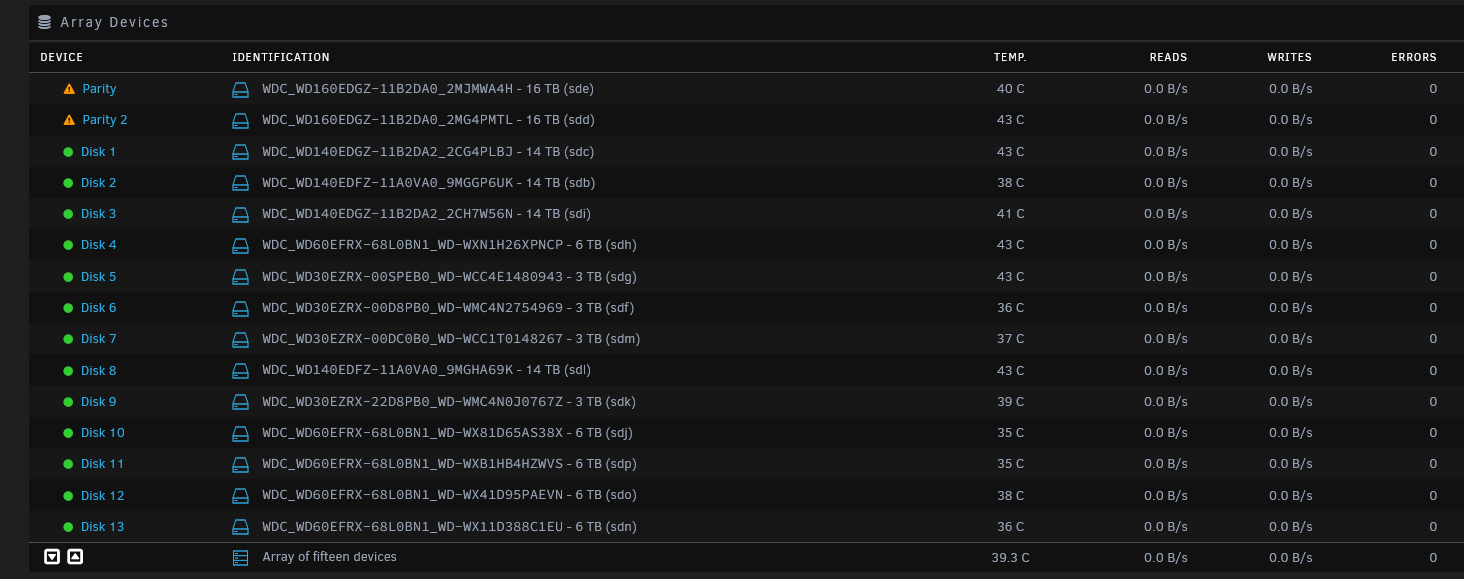

I've come to ask for help because I'm having trouble redoing the parity. In fact, it systematically stops during the process.
I tried to reduce the size of the array, I followed as I had already done this video: https://www.youtube.com/watch?v=nV5snitWrBk
But when I was about to delete the disk, script remove disk, it didn't seem to be finished according to the script, but I had no more activity on the disks.
So I decided to go ahead and remove the disk and run a parity check ... but at one point the writing seemed to stop (as with the erasing), the rebuild/check time increased and nothing happened.
I've tried several times to restart the process by recreating the array with Tools/New Config, but the result is the same. it doesn't work.
I even found myself without web access to unraid, which meant I couldn't see the status of the rescontruction....
I don't understand why the rebuild stops, I don't have any errors on the disks, after rebooting, they're all there. The adaptec 72405 card doesn't seem to have any problems....
how to proceed?

Just to clarify, the server's motherboard was changed last week because the old one seemed to be dead. The new card ran the server correctly for a week.
I'm able to mount the server on another installation without using the adaptec 72405 card, is this worth testing?

Unraid driver is crashing, this is almost always a hardware issue, and Ryzen with overclocked RAM like you have is known to have issues, start by correcting that, see here.

before restarting parity-sync, could you confirm that i can change the order of the HDDs, since parity is no longer validated, that shouldn't be a problem? (for organizational reasons for me).

Since parity is not yet synced you can change the disks, just do a new config.
Hello
thanks for the help, it must have come from there. The reconstruction was successful
