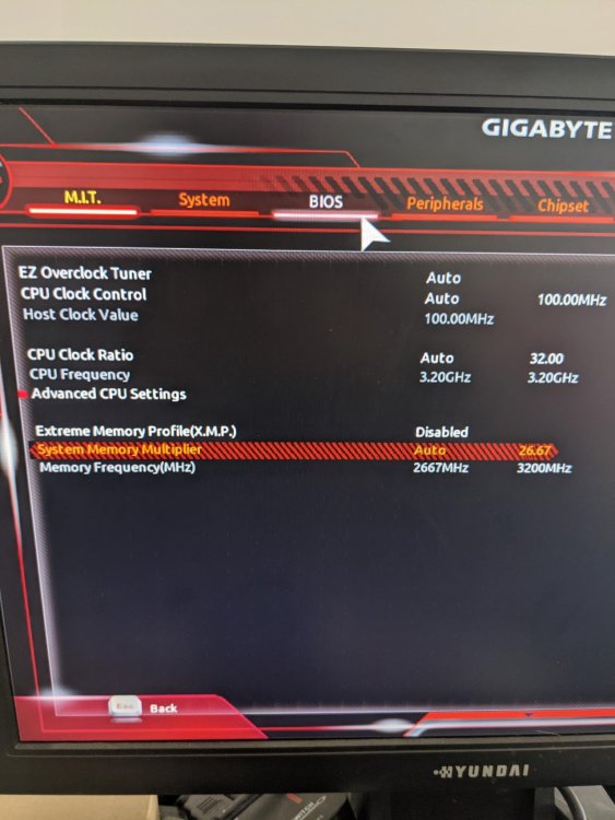

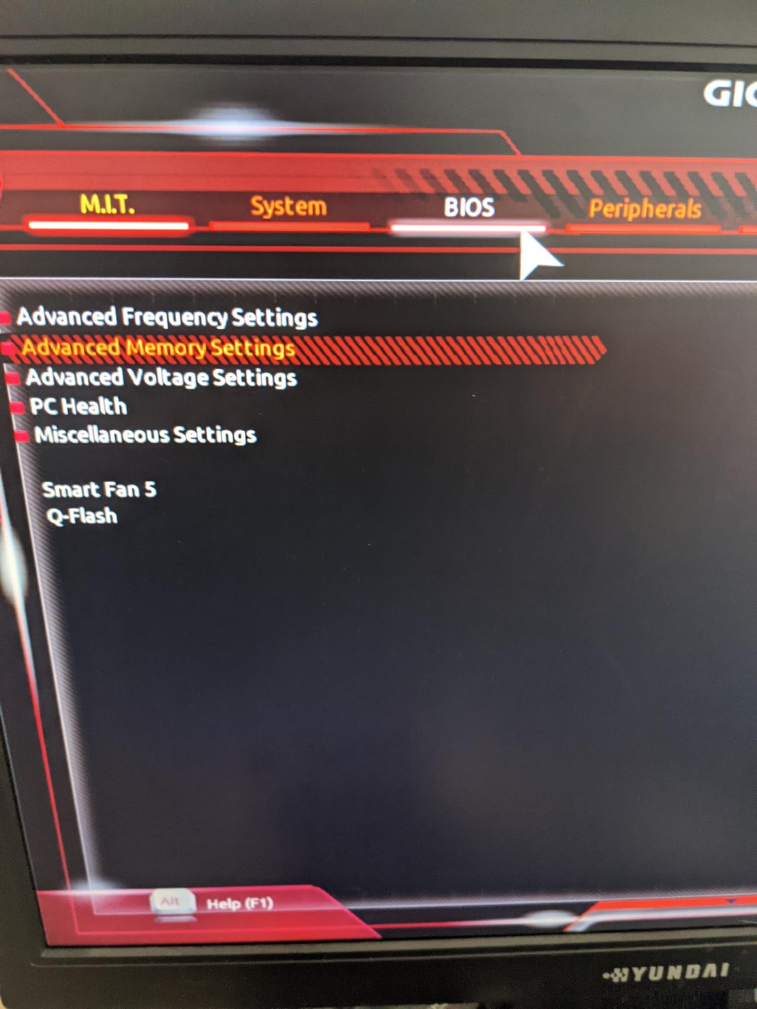

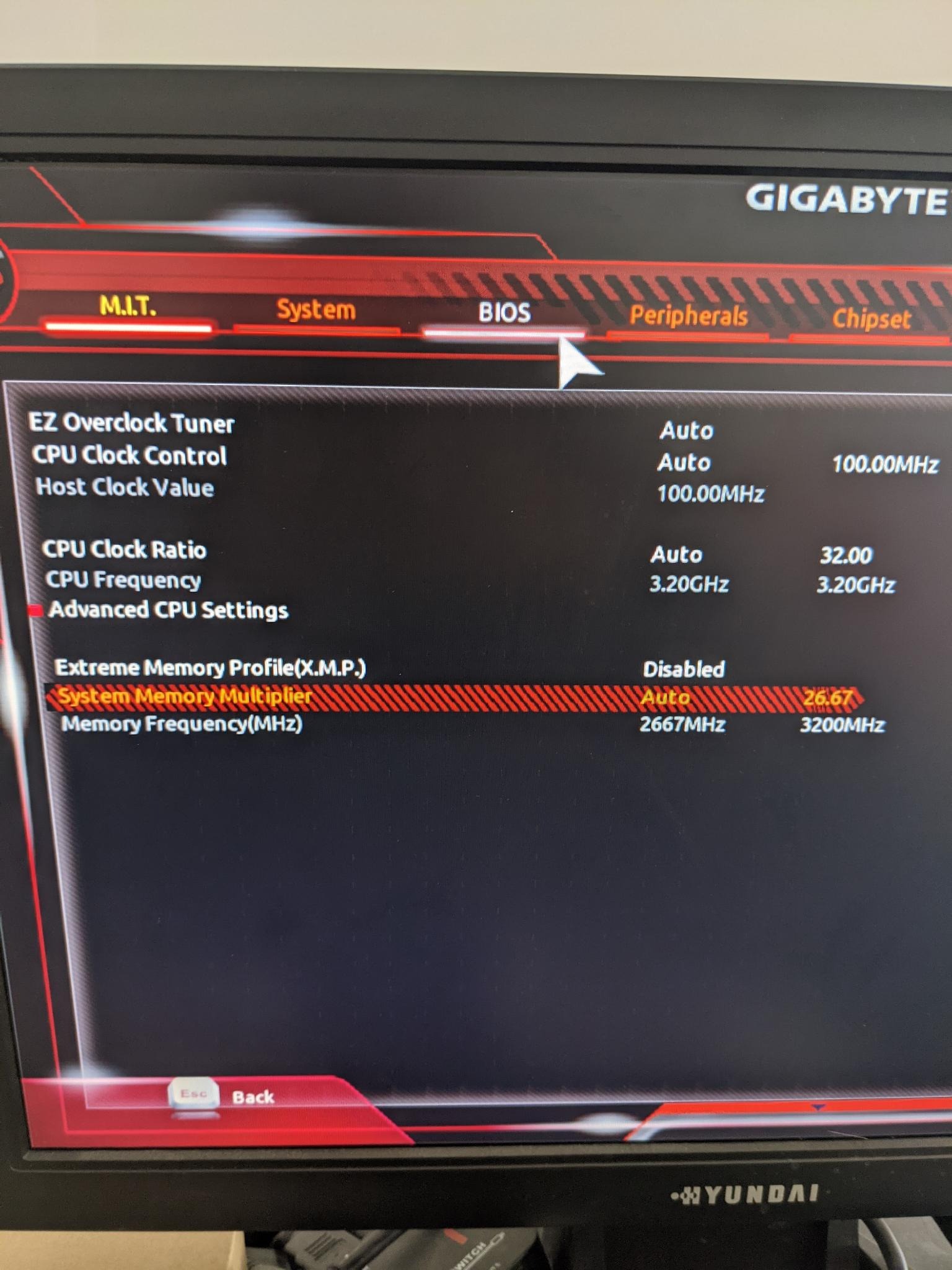

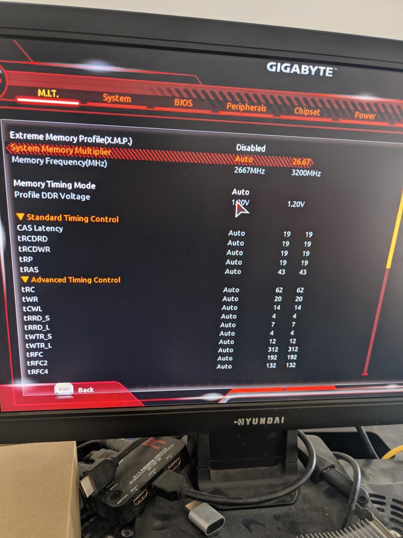

  8. Hello Sorry for the response time, it's been a busy week.... I did the checks indicated above and ended up restarting everything + moving the important files to a single disk, so I know if a disk is critical or not... , and I will have to quickly put an external backup in square . For the ram, I let you see my screenshots of the bios, impossible to manually modify the frequency, I can only go down to 2667 as I have with the xmp deactivated
  9. after research in the bios, and in the doc next door, I can't find a way to go below 2667 edit : or do I have to go to 3733 in dual, to do 1866 on each?
  10. a non correct parity check ? I'm not sure what it is? ok so for the ram I am with 4 bars with a 2700, so I put them at 1866, correct?
