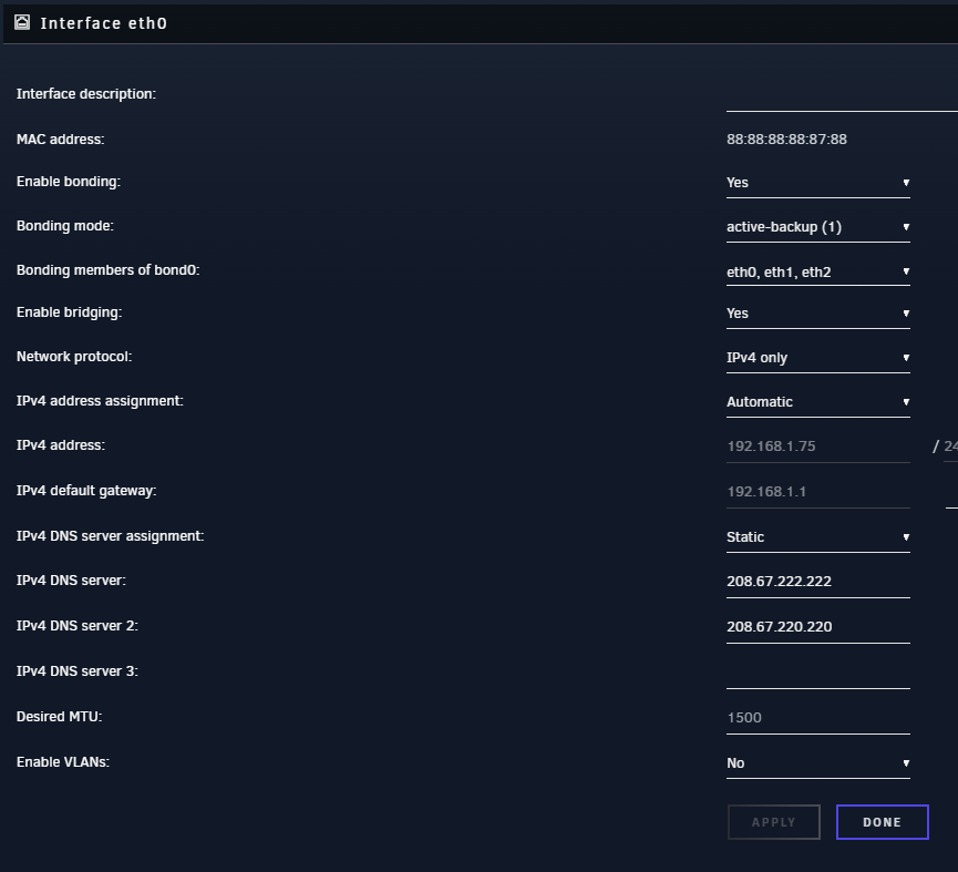

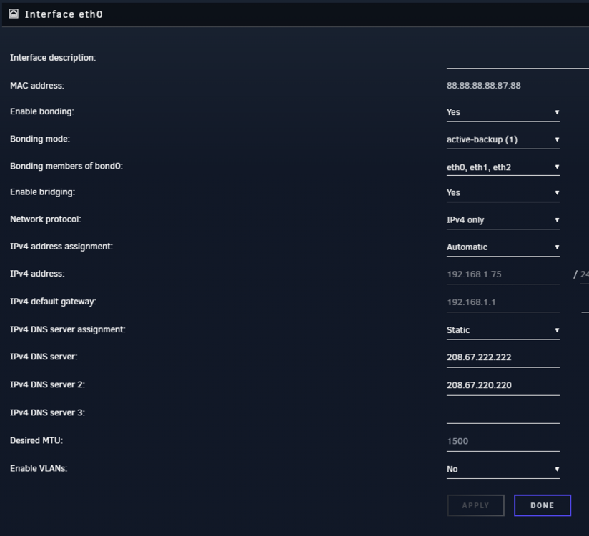

Try changing your DNS server to 208.67.222.222 and 208.67.220.220 instead of using your router.  Settings - Network Settings
can you tell me how? i see dns
Go to
Go to
this didnt help same iss
You still have the router as the first DNS server, remove it, use the other ones as #1 and #2.
like this??

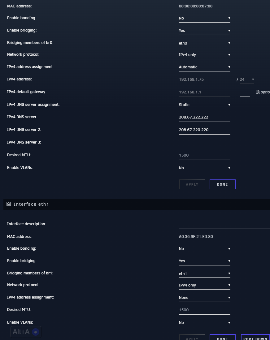

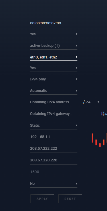

yes its working seems a bit slower now, do i have bonding and bridging set right? i have 3 ports a 10gb nic with 2 ports and my mb
i would like to set it up as fail over, along with using at least one 10gb port for moving files speed
You should not usually use a bond with NICs with different speeds, or it will be limited to the slowest.
so do i turn bound off? what settings do i need?
I would turn it off. Use just the main eth0 or a bridge.

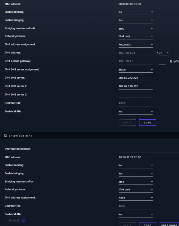

like this?
On 9/30/2024 at 8:57 AM, JorgeB said:
Yep
so i have my MB hooked into my router
and i have my pci card hooked into my switch
so i turned bonding off, do want need bridging off or on?
ive had my router crash a few times due to to many downloads
also is there anything else i need to set? i know nothing about networks thank you
