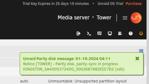

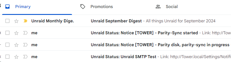

Just did a test, started with a stock 6.12.13 install, configured notifications to use Gmail and it worked:
So not sure what the issue could be
