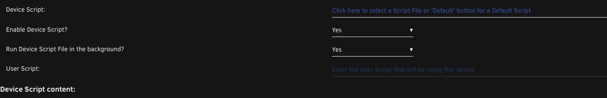

  1. Hi dlandon, Thanks, unfortunately replacing the default script in the Unraid GUI did not work, I've tried this before posting several times, also the drop down menu does not appear when I click on it. I was eventually able to find a workaround using the Unraid console, so posting the solution for any noob like me to save some time in the future. First thing I've done was to adapt the rsync script from the forum user "hoopster" (Thanks a lot for your work!). Then navigated to the settings for the disk connected in the unassigned devices, clicked on default and grabbed the full path provided: in my case: "/boot/config/plugins/unassigned.devices/ATA_ST12000NM0127.sh" I've then opened the Unraid console, and typed: sudo nano /boot/config/plugins/unassigned.devices/ATA_ST12000NM0127.sh Once opened the editor, I've pasted the adapted script and then pressed CTRL+X to save. I then closed the console, went back into the Unraid GUI and pasted the path in the script field, clicked saved and boom...I was finally able to see the script loaded for the disk connected. Last bit I had to figure out was that in order to run the script (at least in my case), I had to enable auto-mount, clicking on manual mount only mounted the disk but did not run the script. I think I could give a custom name to the script file as you mentioned without changing the path but I haven't tested it yet.
  2. Hello Everyone, I've done my fair bit or research but I could not find anything, if something fairly obvious was missed, please accept my apologies and share the link with me. I've installed all Unassigned Devices plugins, and I've been trying to get rsync to work to copy my shares onto a drive which was previously connected directly to the sata port and which I've now connected via usb without any luck. I've tried to create a new script using the one hoopster posted here Post but when I go into settings for the unassigned disk, and I click on device script, while disk is unmounted, I have the ability to write a new path, populate it automatically if I click on "Default" but I don't get a dropdown and once I click save and I go where the script should be saved, I find nothing and also the path vanishes from the field and I go back to the screenshot at the link below. https://imgur.com/a/vKuaUCV So far I've tried uninstalling all UD plugins, rebooting, using different OSs and Browsers, all with no results. Any suggestions or any idea of what might be happening? Thanks in advance.
