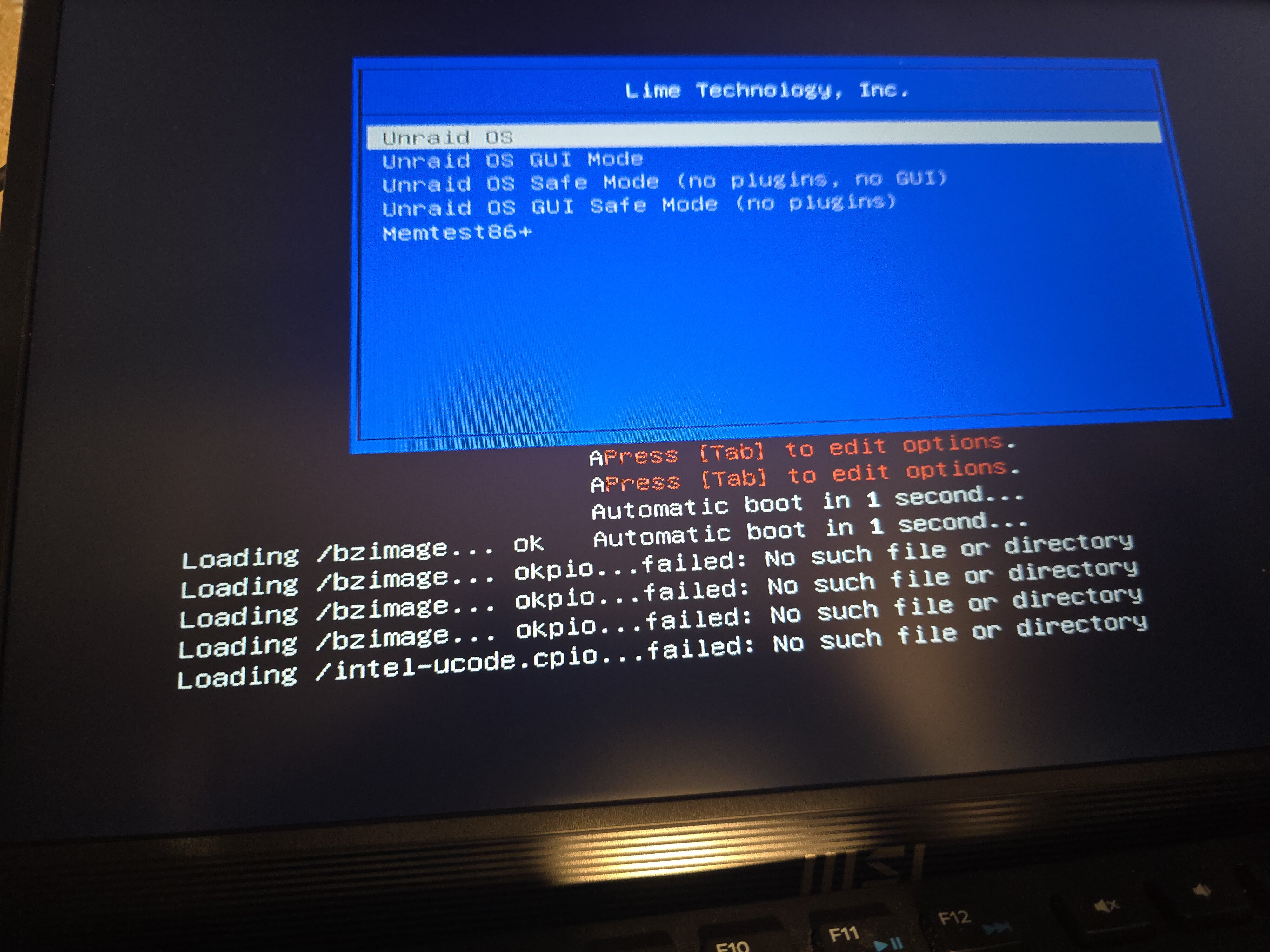

  • Changed my syslinux configuration for the boot entry "UnraidOS" to (Main > Flash > Syslinux Configuration)
    kernel /bzimage
    append initrd=/intel-ucode.cpio,/bzroot
    to load the microcode loader(?)
  • reboot

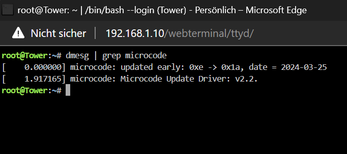

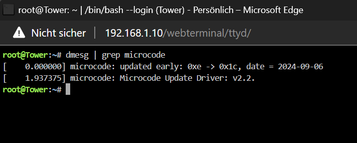

  • Checked with
    dmesg | grep microcode
     plus
    dmesg | grep -i microcode
    aaaand for my understanding, looks like a success!
    Microcode Version for my intel 7400t was from 2023-03-29 and is now 2023-09-28.
