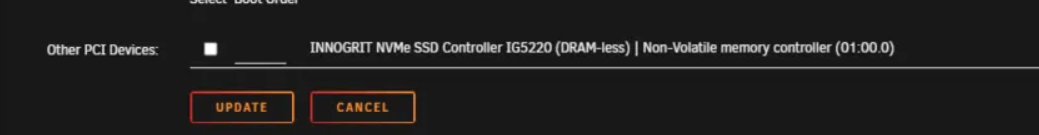

It shows in other PCI devices check box
What do you mean exactly? It is not used in any other VM!

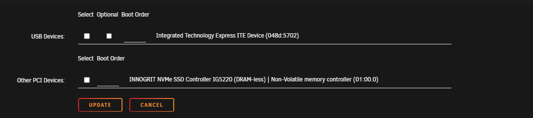

In the VM template
This will passthru the device to the VM. You can select a boot order also.
I did that, but it had no effect, after starting the VM no boot device
Does the nvme have an bootable os already?
Yes, I can boot from it (Win11) when I change the boot order in Bios.
Edited by powerforum75
Does it go into the ovmf shell, have you tried exit and then goto boot manager and select the nvme?
I have solved the problem. I deleted the old VM and created a new one. This made it possible to passthrough the nvme
