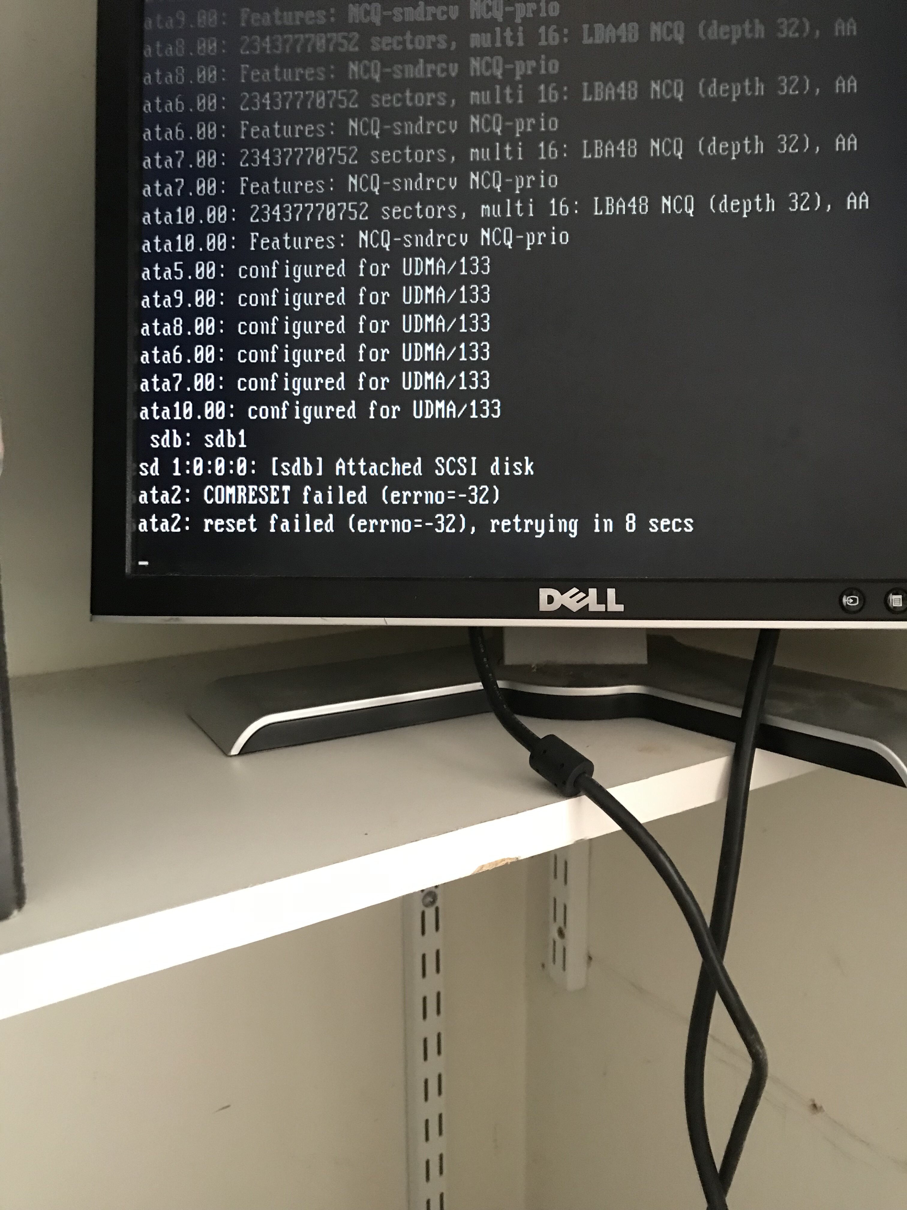

I connected up a monitor directly to the server and rebooted to try to see any messages that could give a clue as to the issue. For a start the server usually boots into the Unraid system within 30 seconds (ish) of booting - just after giving a chance to go into the BIOS, but it's not doing that any more and it kind of got stuck. I manually went into the boot menu to manually choose the Unraid USB stick, and then Unraid launched (I might need to revisit the boot issue later, but it's not my biggest problem right now.
After watching the screeds of code typical of an Unraid start-up, I noticed Unraid get stuck at the point where an error message was showing...
sdb: sdb1
sd 1:0:0:0: [sdb] Attached SCSI disk
ata2: COMRESET failed (errno=-32)
ata2: reset failed (errno=-32), retrying in 8 secs
It shows this a number of times and then it gives up and moves on. This is WAY out of my depth - all I know is something serious is wrong and I need to get it fixed before proceeding.

Solved by JorgeB
Disconnect all disks and see if the server boots, if yes, reconnect one disk at a time and retest.
Great sensible procedure! Thanks JorgeB!
Disconnecting all drives I was able to get Unraid to boot, and then shut down and added each drive in - one at a time, until all were connected and found in the correct location.
The only thing we did find was one of the molex connectors providing power to the lower cage had had one of its 'pin slots' pushed out the back of the connector. Once we'd checked all drives were connected without issue, we shutdown one last time, re-seated the pin, re-connected and fired up the server without any further issues.
